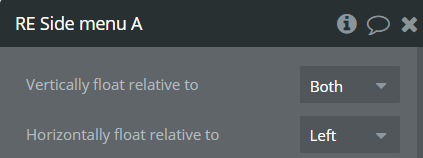

Here’s an example showing the “Vertically float relative to” set to ‘Both’.

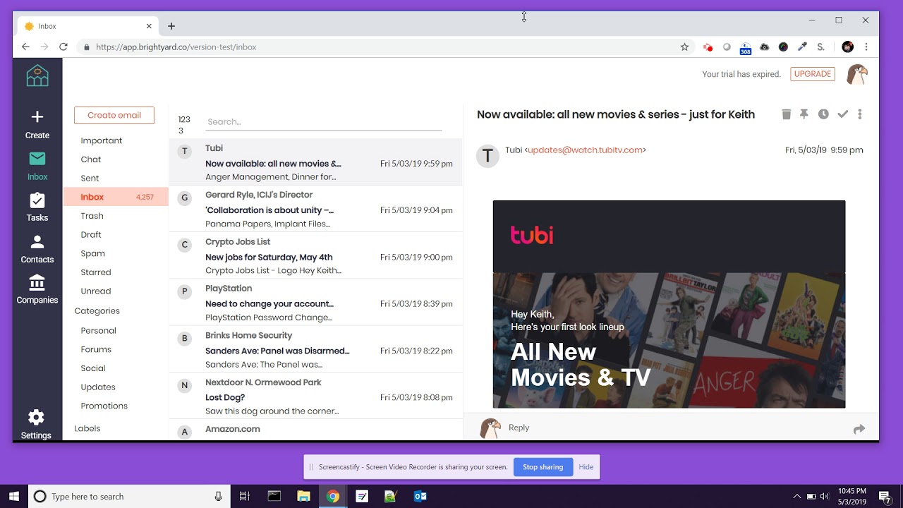

The black colored side menu in the video below is a floating group that is anchored to the top and bottom of the page.

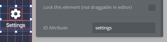

To make the “Settings” icon float I’m actually using CSS to float it (it’s a Group Element) within the Floating Group. This is accomplished by giving the Group Element an ID attribute, then adding some CSS using an On Page Load step in the Workflow page.

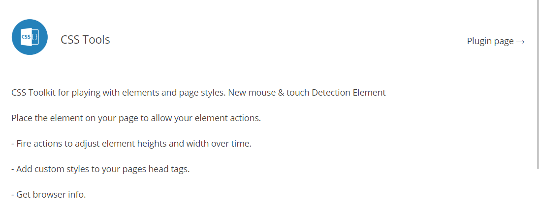

To add CSS in workflow, you need to install the CSS Tools plugin, then add a “CSS Tool” element to your page". This is really only added so you can add the workflow action to add custom CSS.

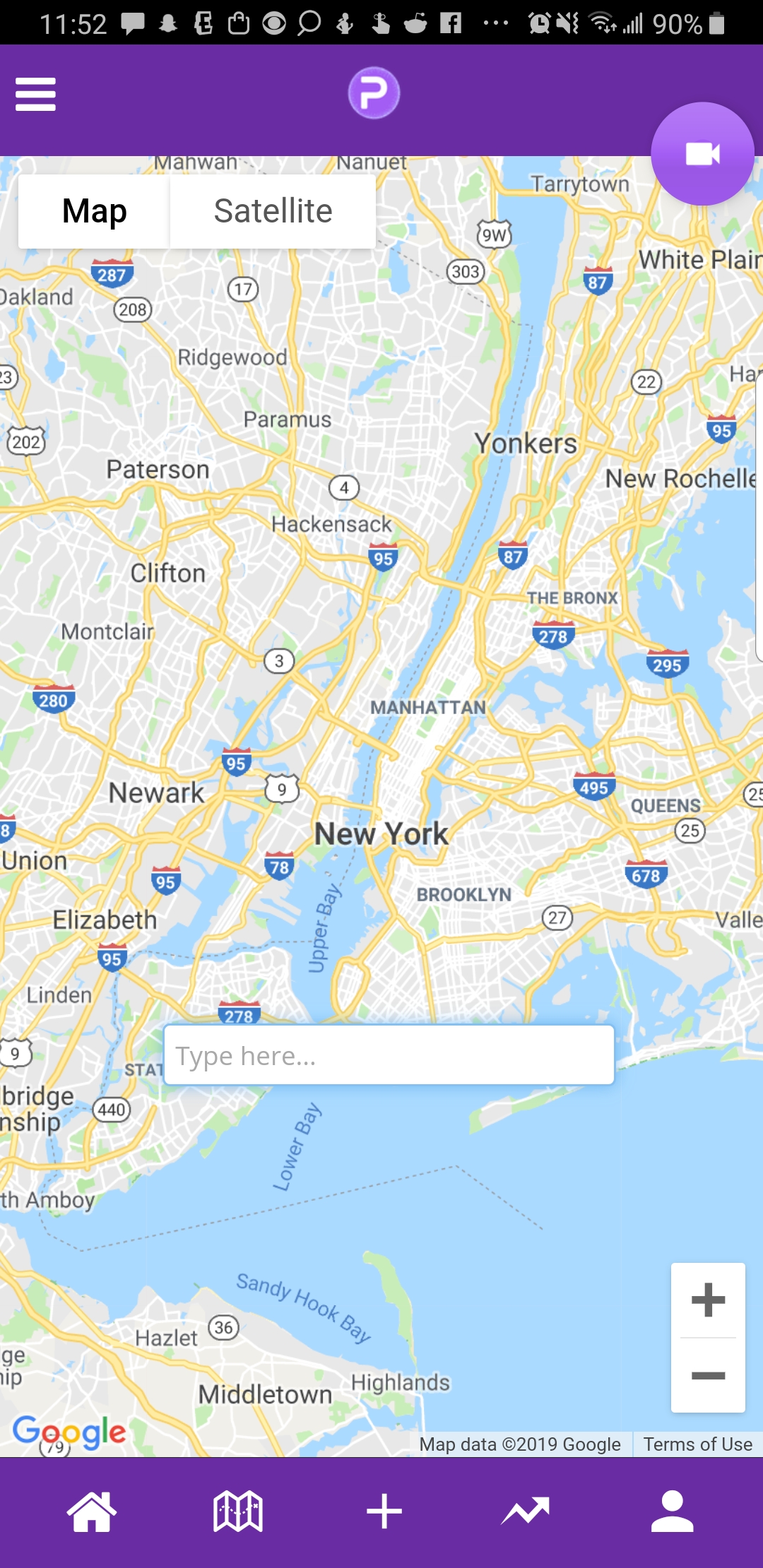

So The second screenshot says alot of my problem. The map is 320x640. I have a Galaxy s9+ which has a pixel height that is longer then 640. But the grey color you see below is the floating group that I attached the map inside of. The floating group seems to know the height of my screen but the map does not. I am just having a hard time getting this concept down. I am adding the map as a plugin I believe. It the google maps that bubble provides I believe.

now I just have to figure out how to make it fit in-between my header and footer! as in this picture. I am more than thankful this has been about 2 weeks or searching for an answer and I finally got it thanks to y’all!!
