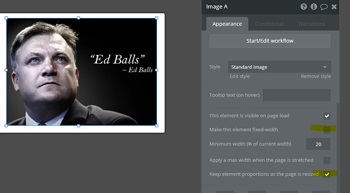

Make sure âŚ
âfixed widthâ is not ticked
âKeep element proportionsâ is ticked.
And then in the responsive settings âŚ
âFixed widthâ is not ticked.
âKeep Element Proportionsâ is ticked.
You can also collapse the margins when it gets small.
Then it should work.
Thanks for the quick response. Your pic looks perfect. I hope to make mine similar.

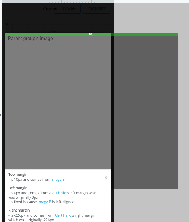

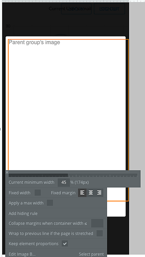

Iâm still getting strange results here, even when I copy your settings (shown below).
Weird aspects
Dumb ideas from here
Image settings
Responsive settings
Responsive explanation
Iphone view (picture blacked out)
Is it the âfixed marginâ in the resposnive settings being on the left ?
I donât think so. I tried it both ways, with the same results.

Popup too small ?
My âresponsive explanationâ seems like the pop up is smaller than the image. And the margins/sizing are adjusted to handle.
Not sure why.
