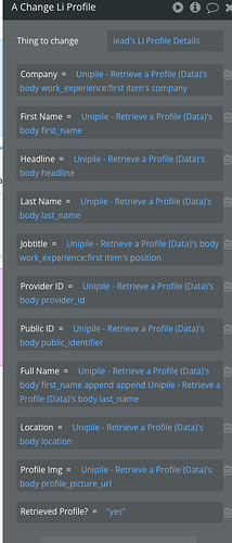

I have no idea what the question is but will try to answer what I assume the question is. As in the case you present - each cell will make another call.
But you can avoid it.
Change the api call from DATA to ACTION.
Make a single action to call the endpoint with proper parameters (whatever you need to send).
Put a response from this call in make a change to a thing flow you have presented, referring the step 1 call.
If it’s an exposed backend workflow it’s even better and then you can also define the parameters to make it smoother (else you can parse the response in any other way). Hope I guessed your question correctly.
