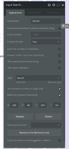

What are the Input search settings?
Here are the settings for the input Search.

your issue actually is that you are using a Text input and the filter expect a Customer thing, not a text.
did you try using a search field with dynamic data set to Customer instead?
In the video, it work, because the filter First name is type Text… and the input is also text.
