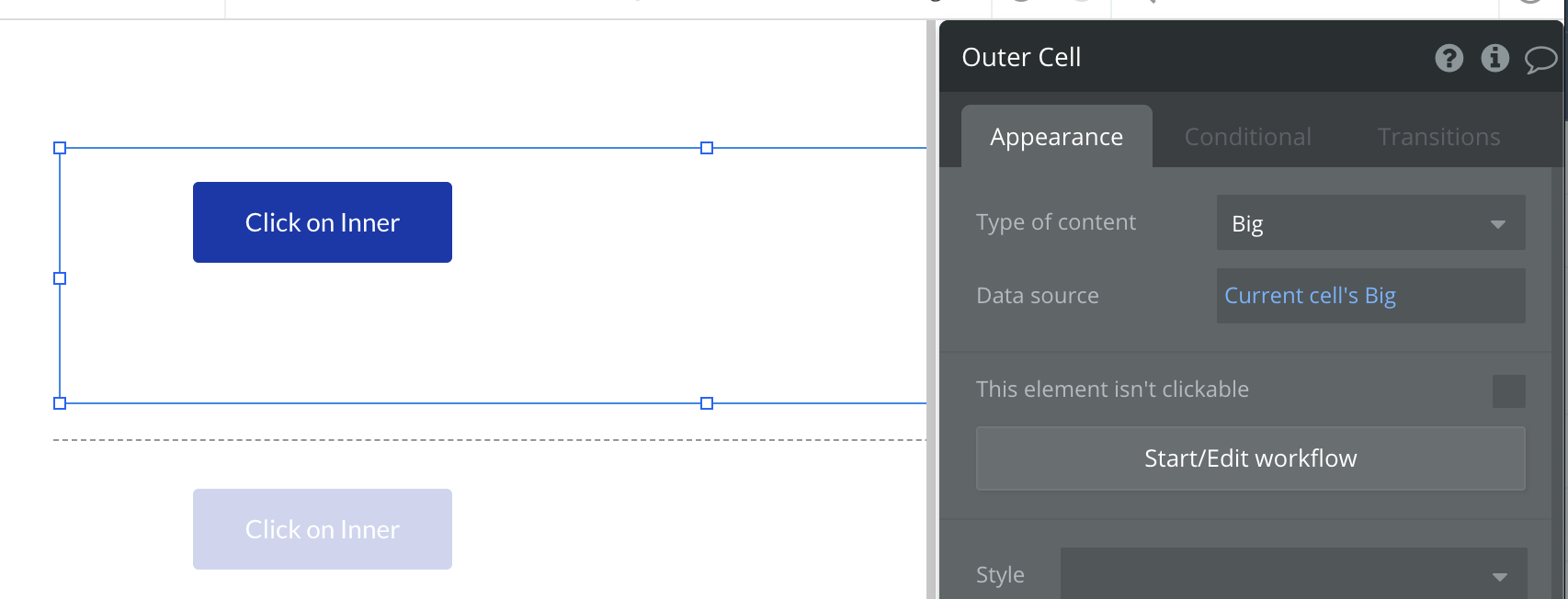

You can place a group container in the outer rg, and set its content to be the outer cell’s object.
Here’s an example:
The outer repeating group:
A group element in the outer rg current cell:

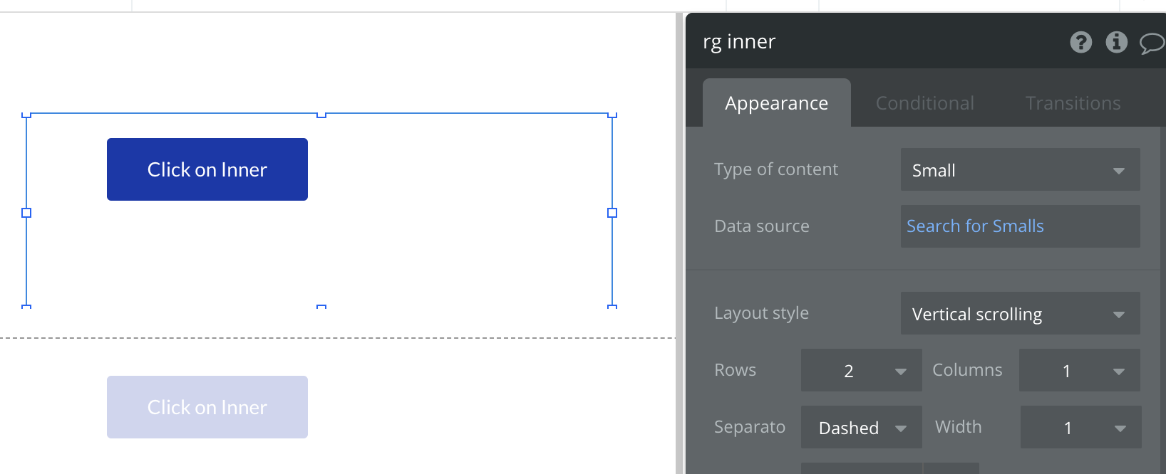

The inner rg:

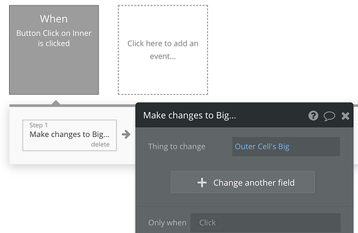

And the workflow for a button click event that references the outer rg’s current cell:
