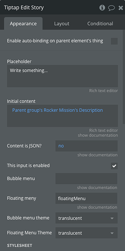

Thanks for the reply. My set up is quite simple. The element is in a groupfocus element. When another element is clicked, it shows the groupfocus element. Then when the group the TipTap is in is clicked, it focus the Tiptap. But the issue only shows using plugnin version 2.0.2. I do have a few TiaTap element on the same page though.
Here’s some screens on the setup.

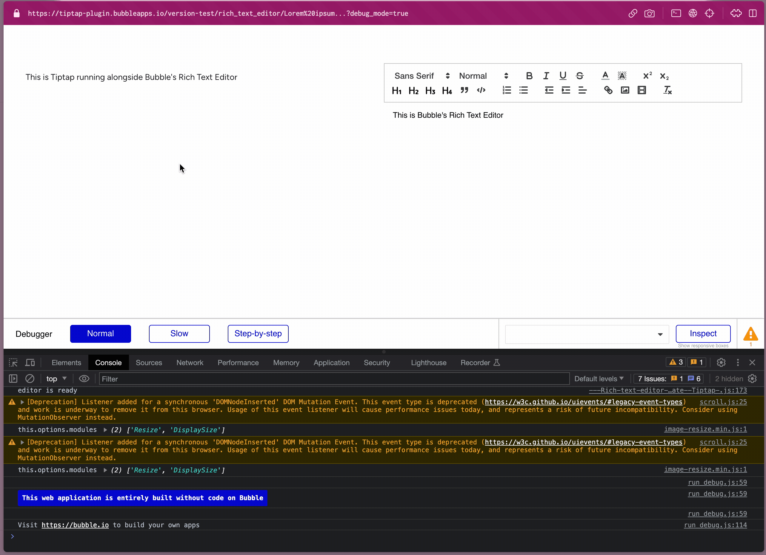

I think I finally got it fixed.
Doing a few tests before I push this version.

Release 2.2.1 - fix conflict with Bubble’s Rich Text Editor
  • under the hood: I’ve removed the attempt to bundle the libraries and just call them as a normal plugin.
That puts a hamper on my attempts to add the paid Tiptap extensions. I’ll have to find a different route.
