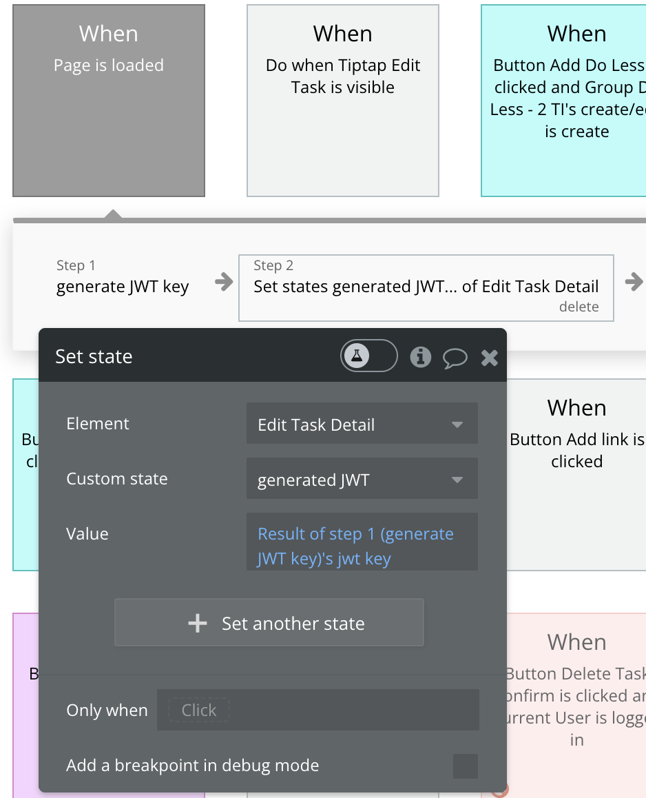

Hi Rico,
I am venturing into the collaboration function of the Tiptap. I followed your instructions to set up the APP secret, app id and generated JWT, etc. However, it doesn’t seem to work.
I have the Tiptap element in a reusable element. When an element is clicked, the reusable is shown in a floating group.
I have auto-binding checked also.
On two different instances, the JWT generated are different. I am assuming that is supposed to be that way, correct?
Is there something that I missed? Is there a way for you to do video with a fake App ID? So that we can make sure we got it set up correctly?
Thanks!

Try turning off autobind.
If that doesn’t work, do send me a DM with the video walking through the app, specially with the browser’s console open.
I’m not sure how the plugin behaves in a reusable with multiple reusables on the same page AND with collab on. Technically I don’t see any limitations.
I need to do a better job with the documentation this plugin. I put together a couple of tutorial videos but haven’t gotten around to the collaboration yet nor publishing all the other ones.
It happens when the editor is inside a reusable element within a repeating group (the trifecta!). I blame it on the reusable element having fit height to content and then the repeating group basically clipping it off.
