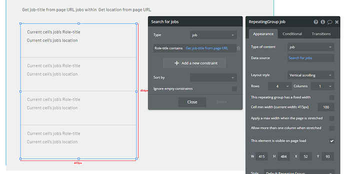

hi folks,
while building a search results page I am getting weird behavior from bubble search query.
in the image below I have a repeating group that works well without constraints and then when I try adding a constraint it doesn’t work when I use “contains”, but it works well when I use “contains keywords”.
even if i try with the same job-title as in the item in the db (lets say “social media manager”) it returns nothing!
i am using the “get keyword from page url” way.
am i doing something wrong or is it the way it is?
i am actually following a tutorial where the guy is using contains instead of contains keywords and it’s so frustrating that it’s not working…
thanks in advance!

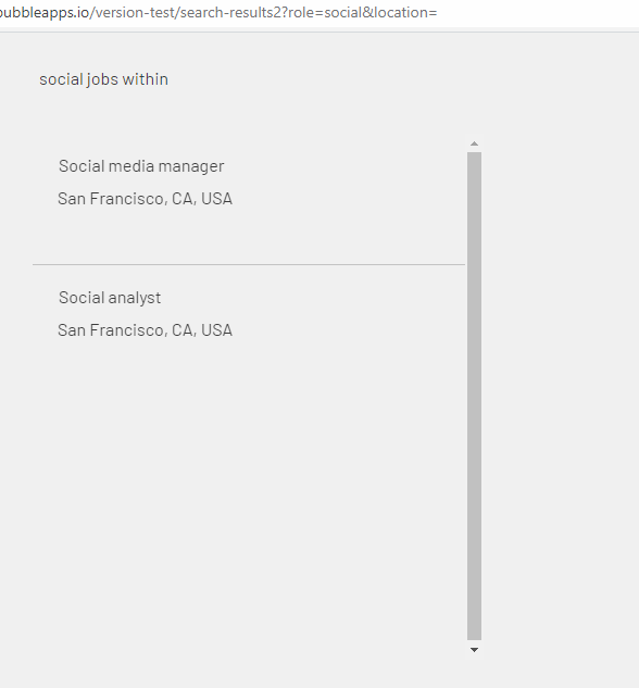

made a few changes and the situation is like this:
  • db field is now “role” (before it was “Role-title”)
(1) search field’s page workflow is sending a url parameter key named “role” (along with the location)
(2) on page search-results2, using the contains keywords i get what i want when i have “social” as query.
(3) changing it to only contains, returns nothing. note that the title prints the url key correctly, so the page is receiving it right.
notice that i didnt have this problem with the location key and setting is as constraint.
:thinking:
The above case doesn’t work because “contains” is case-sensitive. Your “Social…” starts with uppercase “S” while query contains lowercase “s”…
ooh, now i get it :man_facepalming:
thanks!
