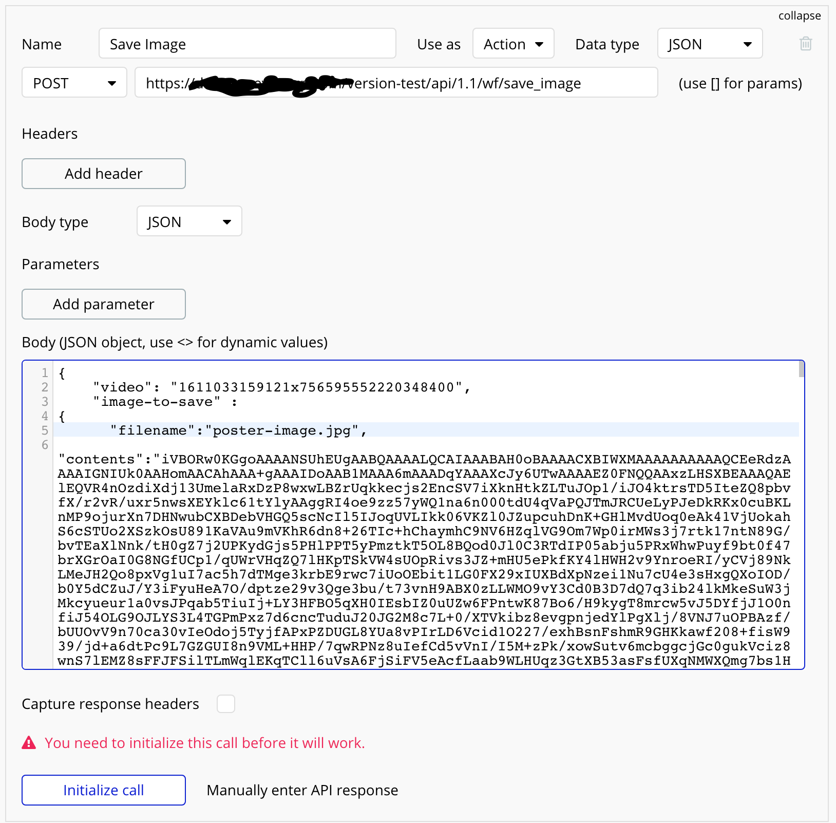

I cannot seem to replicate this functionality. I have an API returning a base64 image. I can’t seem to get Bubble to accept it. Does anyone have any more in-depth instructions on how to use an API workflow to accomplish this?
@jamesdevonport @JohnMark @lottemint.md
Any ideas what I’m doing wrong here?
Called by API Connector:
Initialize gives this error:

When I try this, I get this error upon initialization:
"There was an issue setting up your call.
Raw response for the API
Status code 400
{“statusCode”:400,“body”:{“status”:“INVALID_DATA”,“message”:“Invalid data for key contents: not a valid url or object”}}
I must have the API endpoint configured incorrectly… The “content” key is set as “image” currently.
Ok, wow. Instead of my own API endpoint, I tried it out at the website_home_url/fileupload and hello built-in undocumented feature!
Thanks for pointing it out!
