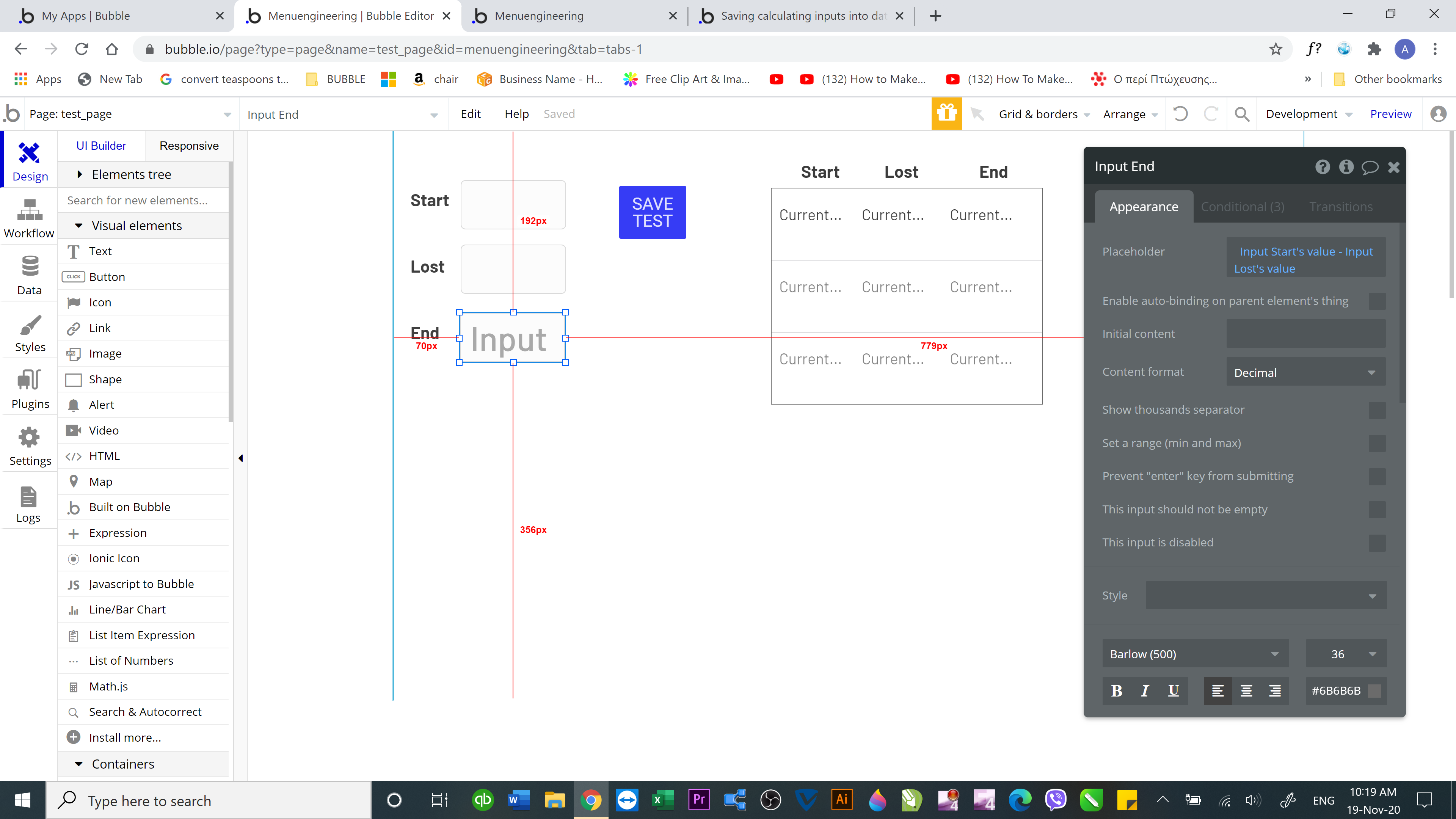

I created a Test Page to test just one calculation but get no result
Maybe this will be more clear
OK @Akispapas, I see the problem. Your formula is in the wrong place. It needs to be in initial content, not placeholder.
