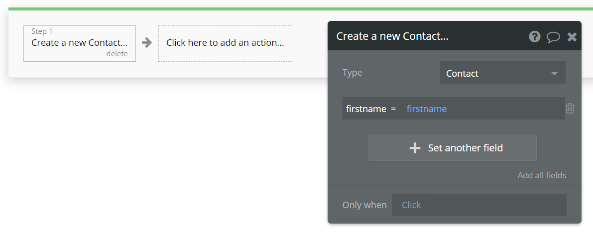

save_contact_to_databas has the firstname parameter. I use it to create a new Contact and save the first name to the respective field in the database.
However, I don’t see any changes in the database and I don’t have a clue why that is.
