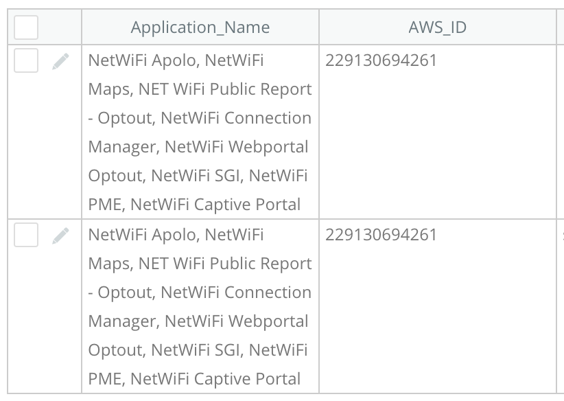

I’m making a Post call (API Connector) to an external API and getting the following array/ list as a response:
I then have a button that will save that result to the Data Base. But here is how it looks like…
Instead having each item of the list a separate row I’m actually getting all the results in the same row.
What should I do?

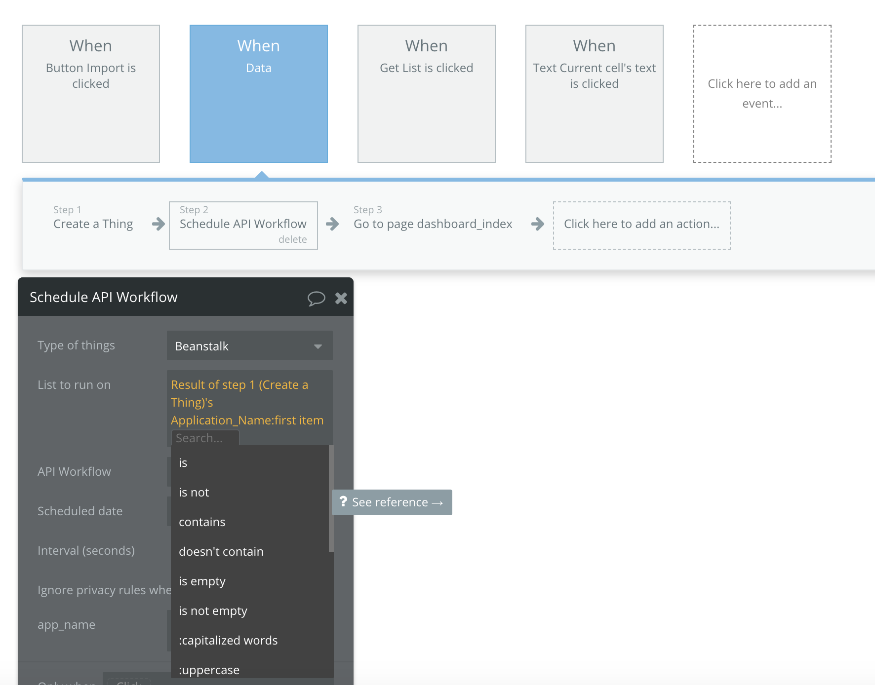

So… I setup like you said my “data” Workflow calling the Schedule Workflow API. The only thing that I did different it was adding a first step that would call the API and save the data so the Schedule Workflow would work on that data.
Step 1 - Create a new Thing
Step 2 - Call the Scheduled Workflow
Please notice that on Step 2 the “List to run on” is actually a search on the data thatI recorded on the first step. For my Parameter “app_name” I’m getting the “First Item” from the “Result of Step 1”
Step 3 - Scheduled Workflow Setup
Now I’m creating a new Thing with my Parameter “app_name” from Step 2

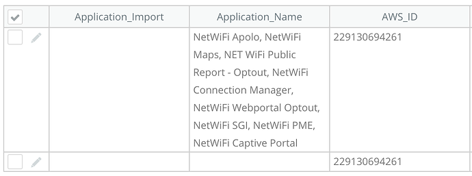

Step 4 - Result
As you can see I’m not getting each item list on its individual row. Rather I’m duplicating the entries
Any ideas?

But… when I tried to change my “List to run on” to Result of step 1’s application name I get this loop (see the print)…
I’m adding “Resulto of Step 1” and “Application Name” but I still get that yellow and then red text.
Change “Type of things” from Beanstalk to text… it’s because it’s looking for a value that is a list of Beanstalks. Your list will be a list of texts, so you need to define the Type of that list as a text. Right above the expression in your screenshot.

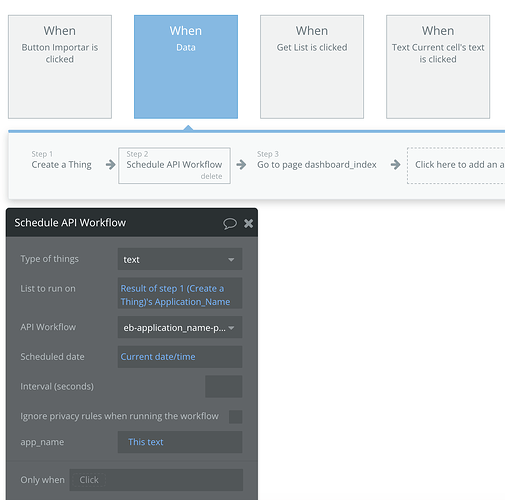

@romanmg tks Gaby… but still no good.
Step 1: Did all the changes you mentioned
Step 2: Result
Am I doing something wrong on my endpoint configuration?
Would you mind sharing your editor link? I would also change Application_Name to a single text rather than a list of texts, but even with the list type, there should only be one name added and you should have multiple records, one for each text.

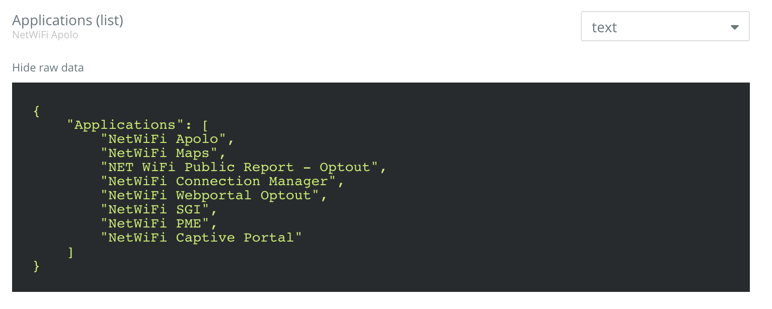

Ok fixed. There were a few things:
  1. You have 2 (what looks like) identical API calls. I’m not sure if one of them was modified somehow, but the response’s “Applications” field wasn’t registering as a list of texts. It was coming through as one string, so I removed and re-added that call to your original workflow on the dashboard page and it’s reading it as a list of texts now.
  2. When you first “Create Beanstalk” on the page, you needed to use “Add List” not “Add” in order to add multiple items to the list value. Before, it was only adding a single value (the entire list) as a single text, so that’s why the API Workflow was only running once and putting everything in the same field.
