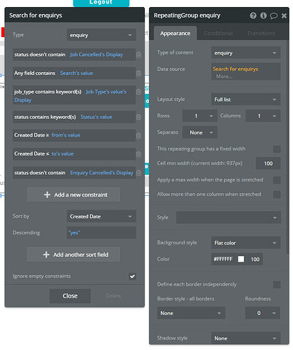

I then have a repeating group that looks at all the enquires and in this repeating group is a jobcard that shows information from the enquiries table and the customer table (Which works and is right)
The repeating group is set to Enquiry and I have now put some search bars at the top to filter for date and a text field. I want to include a drop down for business name which I have done but the search results come back with nothing as this is all in the customer table not the enquiry table
I have tried a merge with do a search for customer table but it gives me a red text error

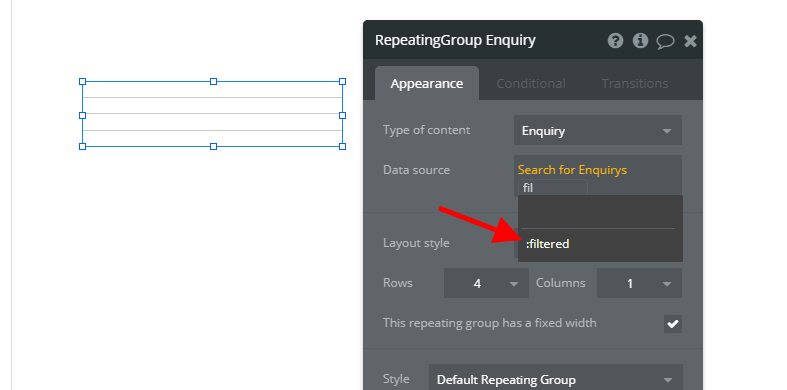

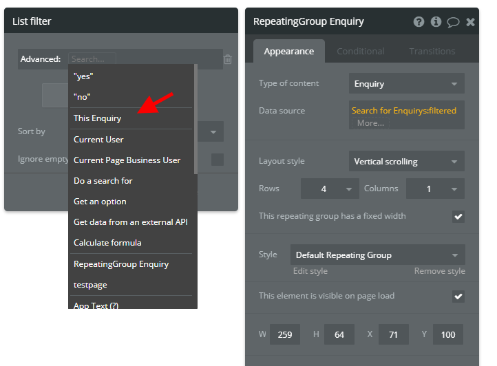

It seems you need to filter.
Try search enquiries:filtered
Choose advanced
Build the filter expression from there

The pic shows a search.
In Bubble this is filtering (it happens at the client level):
Hope this clarifies my comment :slight_smile:
