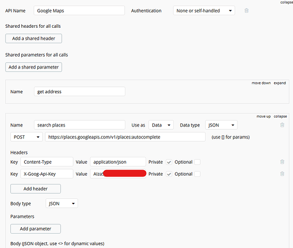

@gary45 @diegoleiter here’s the solution your after:
Create manual places API call to google cloud, saving as Geographical place data type:

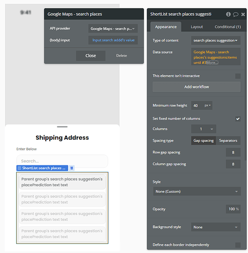

Search using textbox as input:
