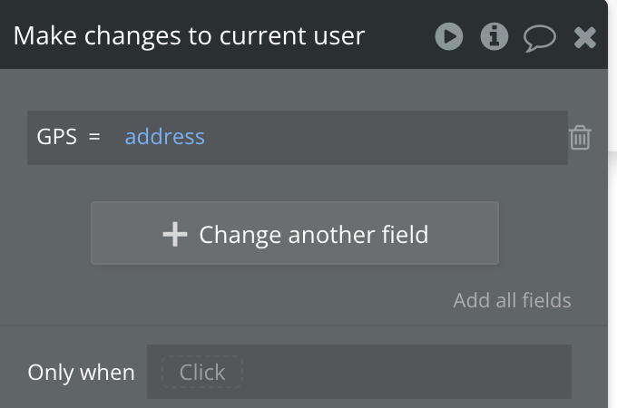

And when I try to use a text input and save it directly to geographic address field, I get this error message:
update, I fixed it with this:
