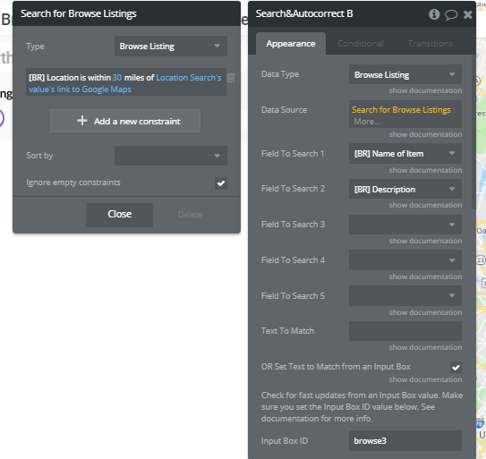

So as you can see from the screen shot I have these fields that impact my search. The main bar where users can type what the item is, the distance, shipping or in person, location and time to rent and return an item.
This information feeds into a repeating group beneath it. I’m not quite understanding how to make the connection between these inputs to feed into the repeating group?
I have tried the search and auto-correct in order to cater to mispells and displaying of my items but when my users search it only applies filters if they are filled out beforehand and not afterwards. OR if not all filters are filled out, then nothing is displayed. It is similar to eBay is what I am trying to make.

Solution:
  1. You do not add any constraints to the Search and Autocorrect settings (Picture 2) ; you add them to the List of items Repeating Group by using “:filter” (Picture 1)
  2. Since my results appear automatically; I need to consistently press the magnify glass to show the results. So I suggest using a “Apply filter” button so the users understands to press the button to get the filtered results. See the pictures below to help you out (Picture 3)
  • My Apply Filter button is called “Test”
