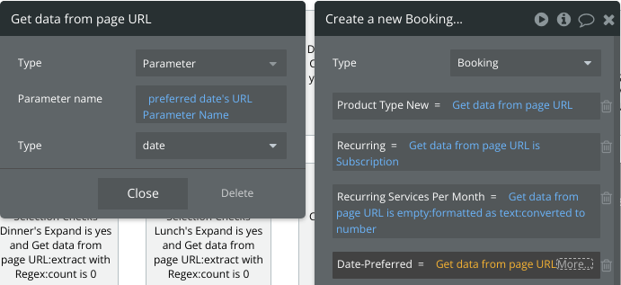

When you have a group on the page, that is supposed to be shown based on the URL parameter value that is an option, set the data type of the group to the option set type, and set the source to the option it is to be visible for. Then set the conditional to be Get data from URL is this groups option value. Change parameter to make it visible when condition is true. Set the ‘visible on page load’ to no and collapse when hidden. Then after you set up the first, simply copy and paste and change the datasource for the next…this makes it so you do not need to keep setting the conditionals, especially useful for a SPA or dashboard page with multiple groups.
When you use the Get data from URL which is for the parameter, and the value of the parameter is an option, do not leave the type as text, but instead declare it as the option set…this way Bubble will URL decode the value and it will match your option display value. This is especially helpful when you go to save the URL value as an option into a data field that is an option.
Screen Shot 2024-07-26 at 8.58.39 PM
Screen Shot 2024-07-26 at 8.59.06 PM
The only time to leave the type as text when using the Get data from URL is when you want to determine if it is empty or not, otherwise, you would likely always want to set the type to the proper type of data that it is.
