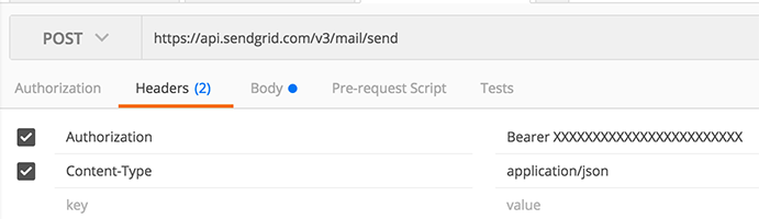

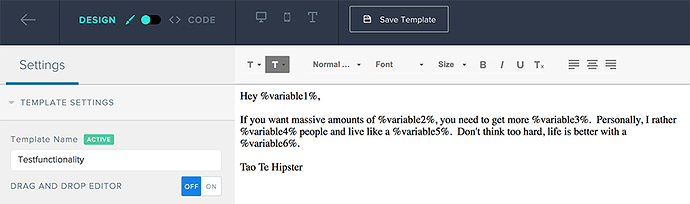

For anyone interested, here is my API call to Sendgrid for inserting dynamic data into a template using Bubble’s API Connector. The issue I was having before had to do with the sections and substitutions tags - if you just want various %tags% substituted into your SendGrid template, you should just use substitution tags.
Here is my template, just pop it into the API connector. I always prefer to make my own API calls so I can update and control fine details. It works and I have it live, just be sure to put the variables (%variable1%, %variable2%, %variable3%, etc.) exactly as typed into either your html code or directly type it into Sengrid’s Editor.
1. Use these for your headers (put your API key after “Bearer”):
2. Use this for the body:

4. Update your template inside of Sendgrid:
