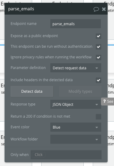

Hey @fayewatson, thanks for the response! This is actually for setting up SendGrid, without Zapier. Here is my API endpoint in Bubble and the options I see:
Ok, I figured out the issue. I was following the format of the “Destination URL” set up in Sendgrid in the screenshot posted above (modifying it for my app), but you have to set it to the one specified in the popup in Bubble after you click “Detect Data” which was a different format altogether.
