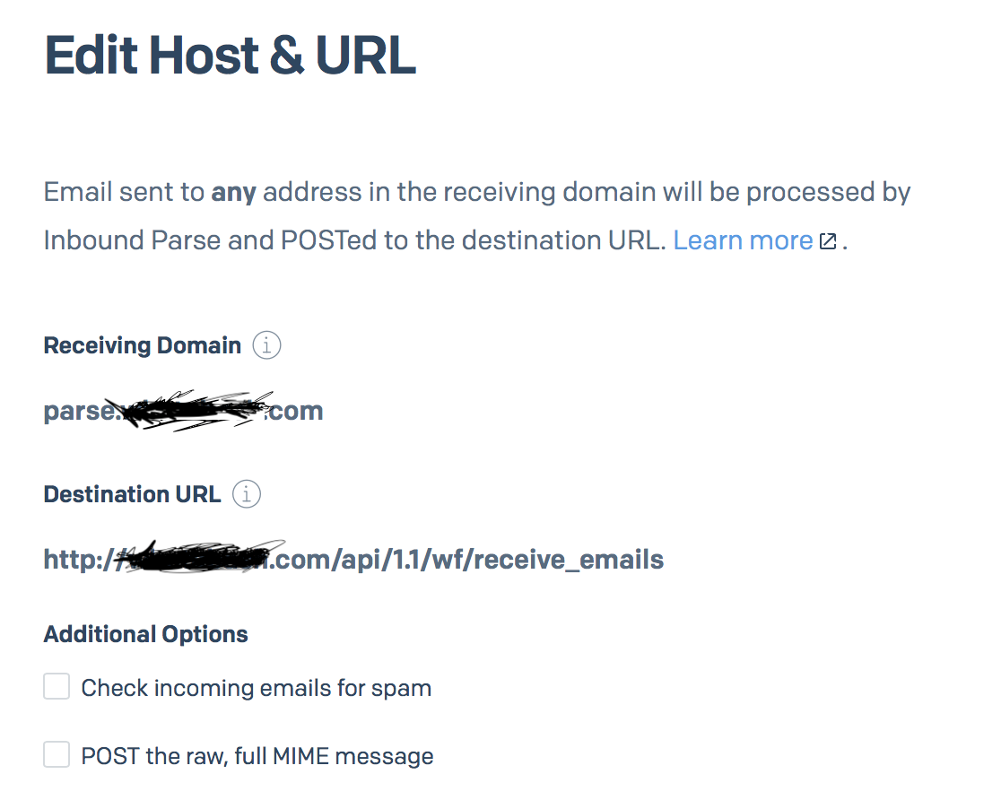

There I’ve set that receiving domain to be parse.(mydomain).com, and set the destination URL to be my API endpoint in my Bubble app in this format:

I tried sending an email to “test@parse.(mydomain).com”. When I did that, the API workflow was not run, so I’m assuming I’m missing something but I’m not sure where?
Hm… Really tough to tell without being able to actually get in there and troubleshoot. Are you getting any bounce messages when you send the email (domain doesn’t exist, etc.)? If so, the subdomain may not be set up correctly with whoever your provider is.
What I ended up doing was creating the subdomain with the provider (I was using Digital Ocean) and just putting the MX record in there; so rather than put the MX record on “[mydomain].com”, I put it on “parse.[mydomain].com” and just put “@” as the hostname (rather than “parse”).
Hope that made sense…

@nnich19 It’s working now! :smiley: I’m still not sure why the POST call wasn’t running before, but then it began to. Then I used “Detect Request Data” for the parameter definition. It seemed like nothing was happening there, but it just took a minute for the parameters window to show up in Bubble. Now everything is being brought into Bubble as expected! Thank you so much for pointing me in the right direction.
