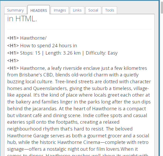

  • Your h1 tag should include the keyword you’re trying to rank for. Yours is “How to spend 24 hours in”
  • There are no h2 or h3 tags at all

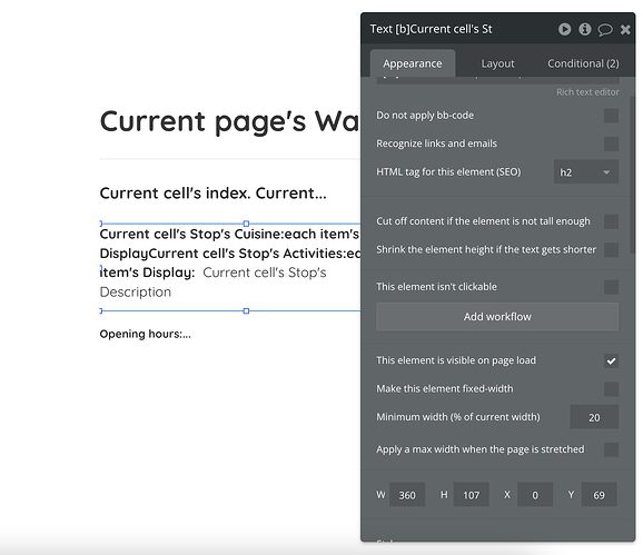

It’s not so much that I rank low, it’s that I don’t rank at all. I just searched “How to spend 24 hours in Hawthorne” and didn’t appear in any of the 12 pages on Google so I think something weird is going on. I also do have h2 tags (see screenshot) with all the content rich stop descriptions on each page so I am not sure why they aren’t visible.
Got it. I did a quick f1 search through the source code and it didn’t pull any h2 tags.

You’ve got a lot of work to do in order to make the ON Page SEO correct. This has nothing to do with perceived SEO benefits of Bubble, it has to do with an almost complete lack of on page SEO implementation and wrong use of H1 tags. Below are screen shots to help exemplify.

You have your entire article as an H1 tag.

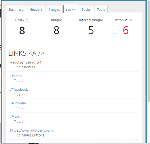

Your links are nearly none, even for internal links. And none seem to have a title.

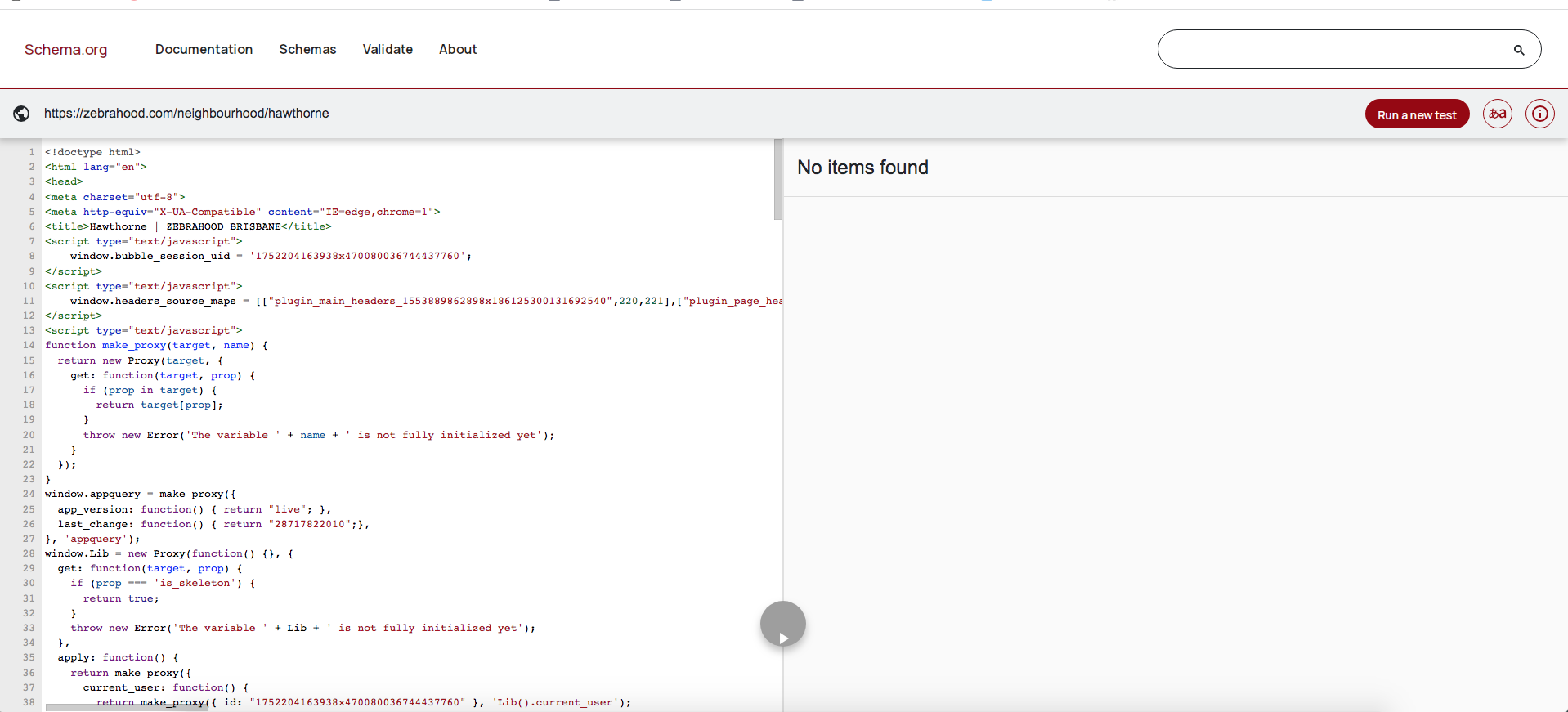

You have no structured data.
