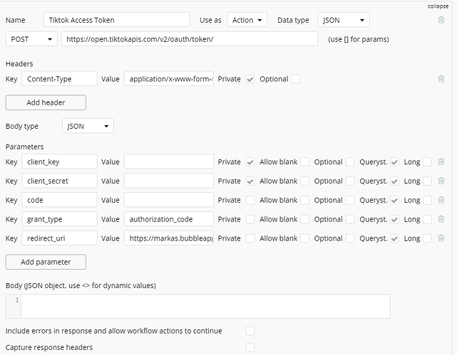

Ok. I get this tokens and open_id. But its don’t save in current user
And I have an error in this request:
You will have to manually save it to your database in bubble.
and what about this error in get request?
I’m assuming the act. isn’t supposed to be in with your Bearer token

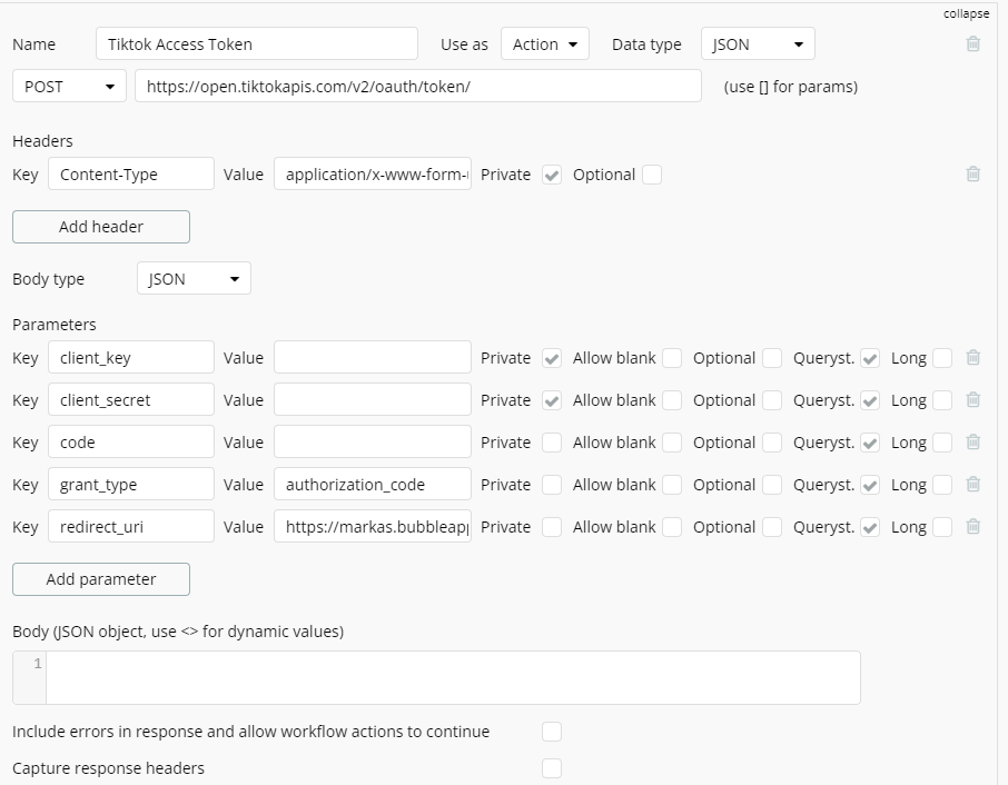

It seems like Tiktok has released a new API - I’ve been getting this error.
When sending this call:
Any idea how we could solve it? Would you be open to consulting over zoom if it’s not a quick fix?

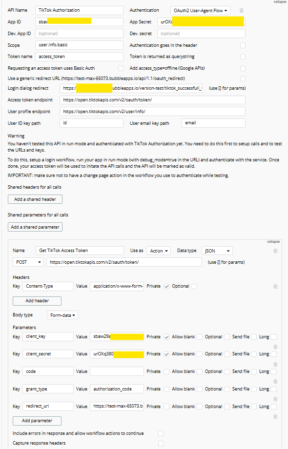

Thanks for all the helpful knowledge that was shared earlier. I’m having some troubles successfully connecting to TikTok. What I’ve succesfully done:
  • Creating a state
  • Sending the state to TikTok, receiving an authorization code & state back
When trying to set up the API, I’m having troubles retrieving the access token. This is how I’ve set-up the API call:
I’ve currently used Tiktok’s sandbox client key & secret, is that ok?
I’m having troubles to understand what I should fill in in the ‘code’ parameter. This should be the authorization code I receive after logging in through TikTok right? But is Bubble allowing me to include a dynamic value there? It doesn’t seem to?
thanks for your help!!

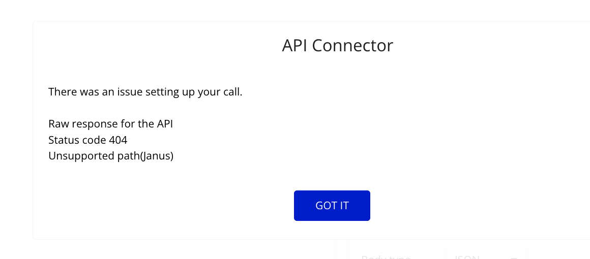

Edit: When manually filling in ‘code’ I’m receiving this error:
