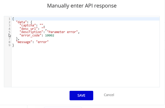

Thank you for your answer. As I understood, after Authorization via Tiktok I need run this action:
By this requst I have an error
Where is mistake. Can you help me?
And how I can Sign user up after that?

@vitaly you won’t run that action directly after pulling up the outh site from tiktok. You’ll call that once your redirect page loads. Have you made your redirect page yet?
Yes, I already figured it out. I have a page redirect, but I have an error in the request (I showed above) if this is a right request at all, I’m confused)
@vitaly looks like you’re missing your ‘grant_type’
grant_type=authorization_code
grant_type=authorization_code - is this code that returned in string after tiktik autorization?
no you’re telling tiktok that’s what you’re requesting
so you need to make a grant_type parameter with value authorization_code
where I can find this authorization_code?
@vitaly the grant type is literally authorization_code
Greate! But I can understand where I can find this authorization_code
@vitaly you’ve already found it. you keep typing it. the value you have to pass to be able to receive a token back is ‘authorization_code’
