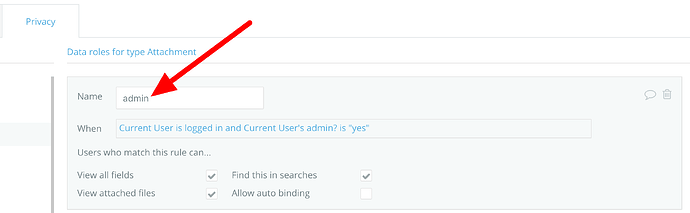

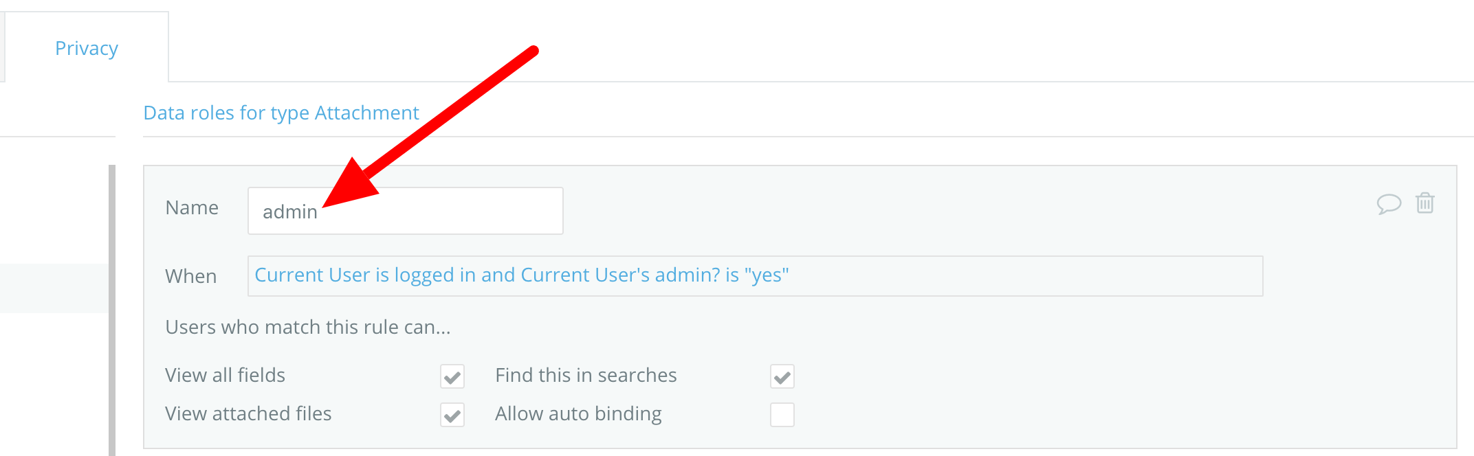

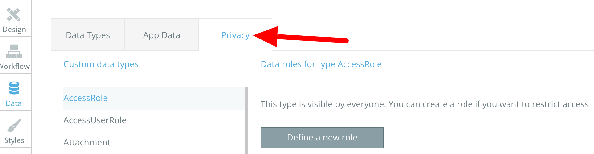

You should first use Privacy settings inside of the Data tab:
If you define user roles and attach them to a user (ex. create data type on “User” called “admin”…make it a yes/no field), you can use the above section to define specific data fields that are visible for that person (i.e when “admin=yes”). Even if you have elements on the page that are visible when someone visits the URL, the data will be blank if they do not meet the conditions you define.

Use Privacy Roles set on the data (under the Data tab). That way if someone does manage to stay on a page they shouldn’t be on, and gets around the work from above, no data would actually show
