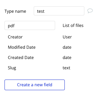

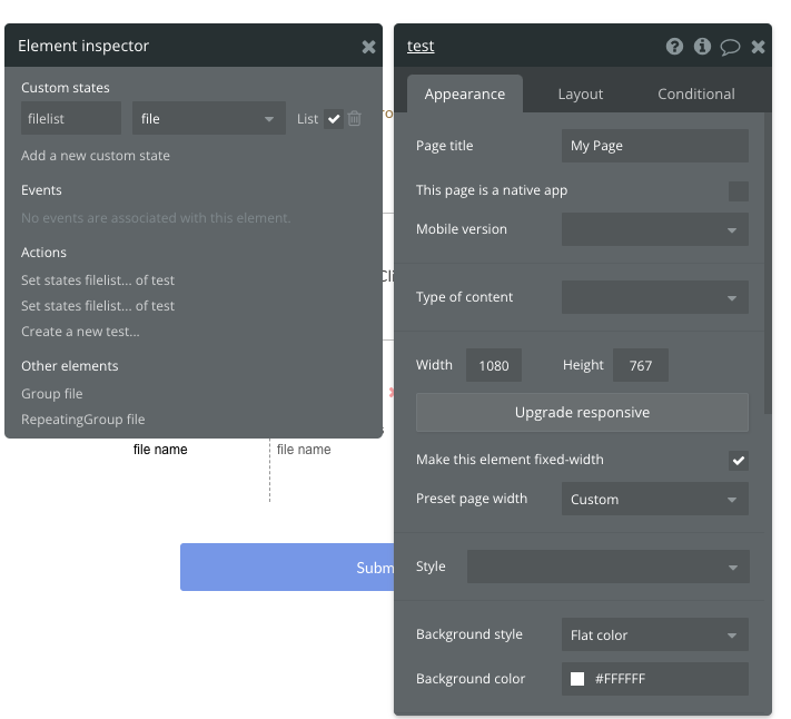

Create a field type in the database as the list of files.
Screen Shot 2022-12-20 at 1.04.39 PM

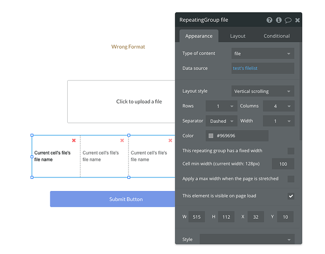

Create a custom state with lists enabled.

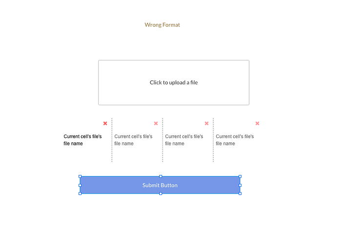

Then use the file uploader element, Alert message (Wrong format), and repeating group.

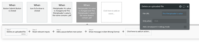

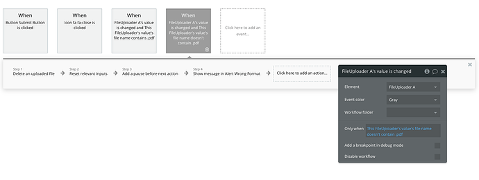

Then start a workflow on file uploader. Set the condition (when the file doesn’t contain .pdf then run that workflow) as shown in the screenshot on the workflow.
Copy the same workflow and change the condition (when the file contains .pdf then run that workflow) as shown in the screenshot on the workflow.
Set custom state as shown when the file contains .pdf

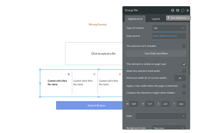

Once the custom state is done. We need to show the custom state data in the repeating group in order to edit the files.

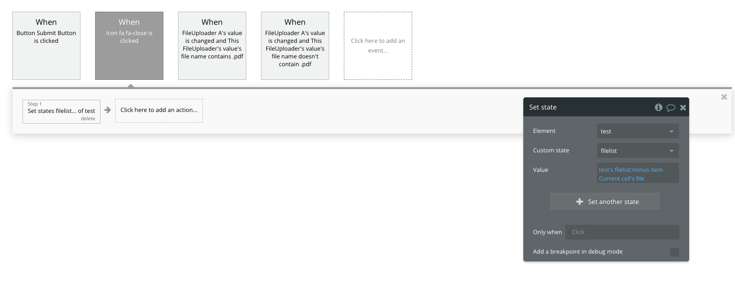

Start the workflow on the delete button which will edit the custom state.

i think i miss something but where u have on "Only When This Fileuploader value "file name " i have :eachfilename because i have list of things and Multi Uploader work with list of Value´s,
i don’t know why the Only when doesn’t work on ;eachfilename it seems not recognize it you know why?
