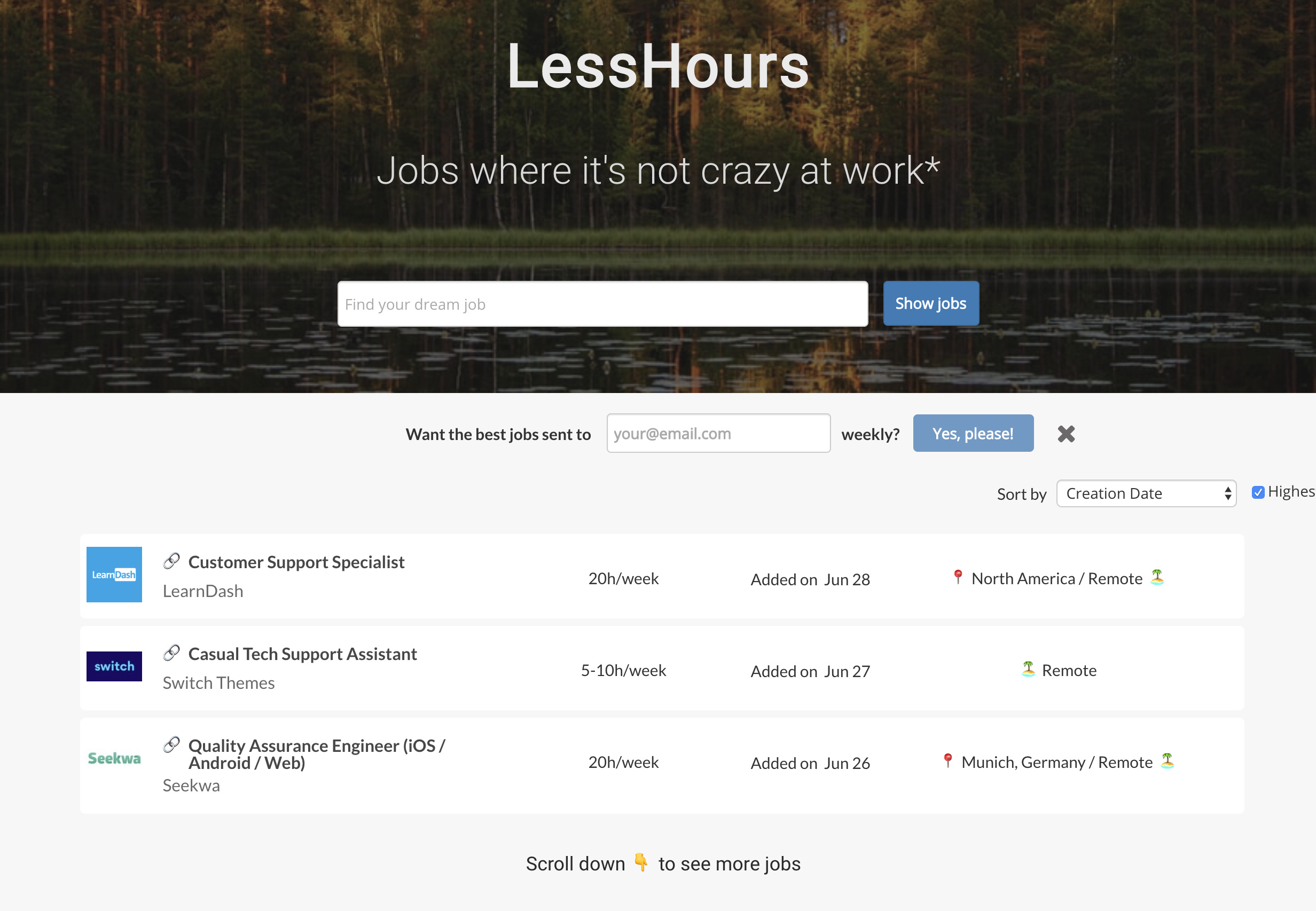

On my site I’m displaying a repeating group displaying a list of jobs, that loads more jobs as the user scrolls down. I’m showing a message “Scroll down to see more jobs”, but I’d like to show it only when there were more jobs to show. Would that be possible?

It’s not exactly what I’m looking for. More jobs are already displayed when the user scrolls down, without the need for a “show more” button. But at first, only 3 jobs are shown and it can seem like there’s only 3 jobs. That’s why I’m showing that “Scroll down to see more jobs” message.
The problem is that that shows always, even when there’s no more jobs to show, and I don’t know how to show it only if there’s more jobs to be loaded. It can be confusing to always show it. Especially when a user does a search, 5 jobs are found and the message is still telling her to scroll down.

I also tried to use the index number, but that can only be accessed from inside de cell of the Repeating Group, and I’d like to display the message under the RG, not in every cell

I know it will simply load more when scrolled down, the message its just show to give some clues to users. Because when loading the page, only 3 jobs appear, and some visitors may think “oh, that’s it, bye”. So that’s the reason to show the message
I can’t use a full list: until and controlling the until with the scroll position and hacking some formula with the height of the rows. Why? That height changes depending on the device type (bigger on mobiles) and also when expanding one of the jobs, that would not work at all. You can see what I mean playing with the site in 1 s
And I would like to NOT display the ‘scroll down to see more’ when there’s actually nothing else to be displayed, but can’t quite figure out how to do that yet :thinking:
