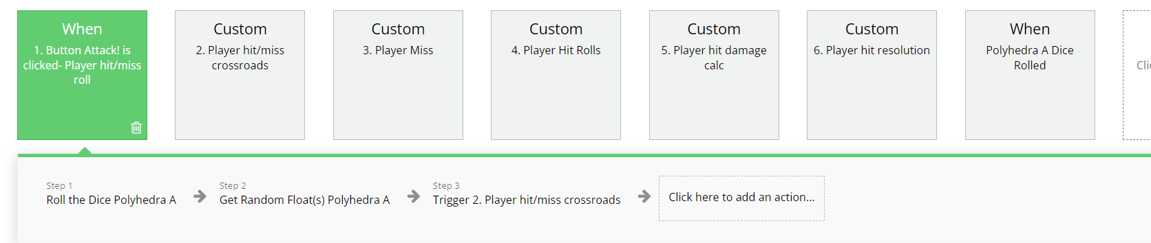

alright… I’ve now found the Polyhedra A Dice Rolled event, but I’m not sure how to get it into my workflow when one button is going to be rolling both a 100 sided dice event (to see if the player hits) and then running damage calculations (1d2 - 1) if they do.
Step 1. Roll the 100 sided dice with modifiers to see if they hit. Also roll the random floats for later use.

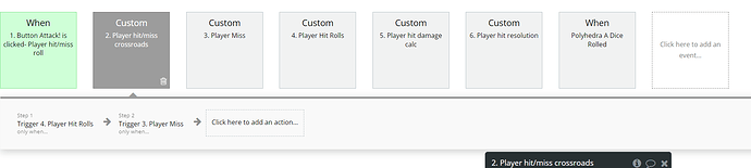

  1. Depending on dice rolls from one, either trigger step 3 (miss) or step 4(hit).
  2. Player misses, this works fine.
  3. Player hits, Parce Dice and Roll Polyhedra A and trigger step 5
  4. I tried adding a pause to give time here but it didn’t work. Pauses for a second, then sets state of Player DMG to Polyhedra A’s Float * Polyhedra A’s last dice roll sum. Trigger step 6
  5. Hides any miss text, sets state of hit flavor text and shows it in case it’s hidden, then sets state of monster health to monster health state - player dmg state…
With this I should be getting a number from 0-2 ish, but I’m hitting in the 50 to 100s… any insight to what I would be missing? I figured setting it up this way would force the dice to fire off before they’d be needed, so I figure I’m either missing something or it doesn’t work that way and I’ll need to rethink my workflow.

Hey @snarec, I don’t have a lot of time to respond just now, but for example in step 4, you’re doing Parse and Roll and “then” triggering a custom event for calculating damage.
Bubble won’t wait for that to finish before triggering “5…”.
So you’d trigger custom event 5 on the “Dice Rolled” event. Now, you’re wondering “hey, Dice Rolled is generated any time I do any dice roll with Polyhedra A so… ummm.,.”
The solution at the moment is to have multiple polyhedra elements: one for player-to-hit, one for player damage, one for monster-to-hit, and one for monster damage so you can differentiate those events.
(A future enhancement to Polyhedra would be to have a string you can pass along with the dice rolls so that you could differentiate between different sorts of rolls. Also, some built in auxiliary states so you could save rolls to some built in states so you could save rolls w/o having to set a custom state. But it’s a free plugin I ginned up overnight, so that’s not implemented yet.)
And just like that you solved the problem. I didn’t even realize you could have multiple running polyhedra at the same time. Awesome!
