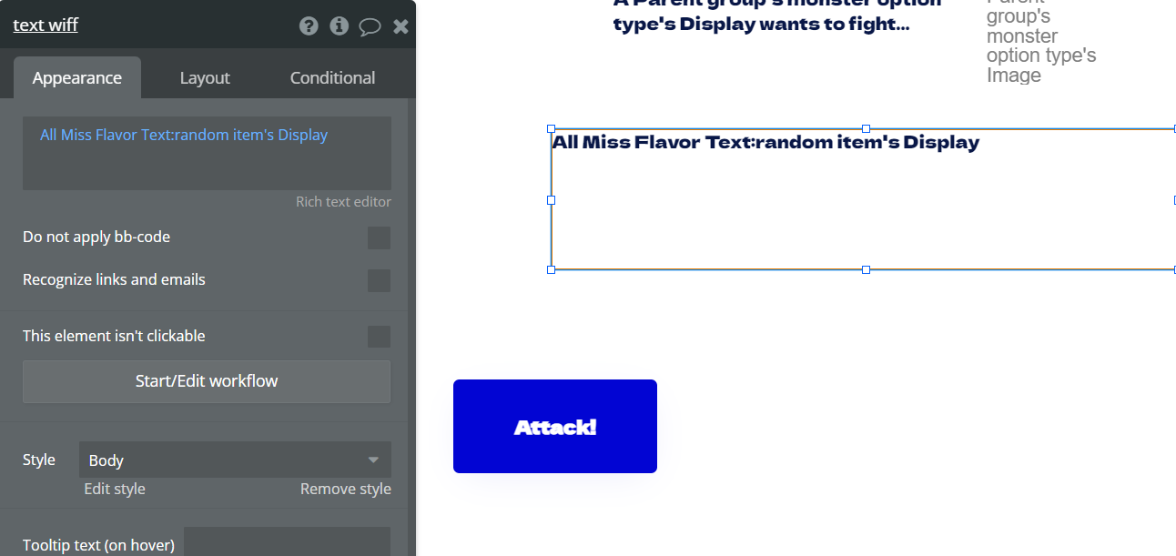

Hello, I’ve created an option set that contains a list of flavor text that I’d like to be able to show on a button press. I would like to pull a random option each time I press my “attack” button.
The problem is, it seems like bubble will only allow you to randomly pull once per page load, and then keeps using that same option continuously after that. Is there a way that I can “reroll” the random pull each attack button press?
Although, @snarec, note that :sorted is only applied when you call that method. So note that referencing some list :sorted by random will not give a random result if you’ve stored that in a state. You need to get “your list” and :sort it by random each time you need a new random value.

Hi there, @snarec… I know Keith’s got you covered here and you guys went in a different direction with this thread, but for what it’s worth, if you set a custom state (which has a state type of Miss Flavor Text) to a random item from the option set when the attack button is clicked (set the state to the expression you are showing in your screenshot without Display at the end) and then show the custom state’s Display in the text element, you will get the desired result of a random item being pulled from the option set every time the attack button is clicked.
I know where you are (well, I didn’t specifically know Palm Springs because that would be weird), and I love that you consider 1:07 AM to be still kind of early.
Can you expound on this part? I’m fairly certain I have the rest of this set up as you say, but when I try and add dynamic data to my text element showing the custom state’s display isn’t an option.
