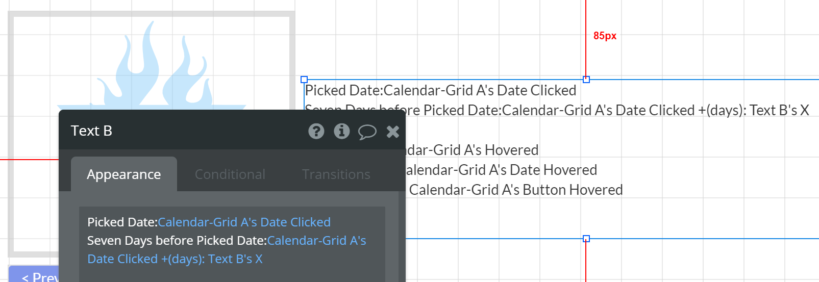

Here’s an example… Here is custom state X:
Now let’s try and build Calendar Grid A’s Date Clicked +(days)-X… I’d have to post a video to show, but you can’t do that (there’s a reason). The closest we can get is:
That is: We can only ADD X. If X contains a negative value then we are subtracting days. But we would have to put that negative value into X.
