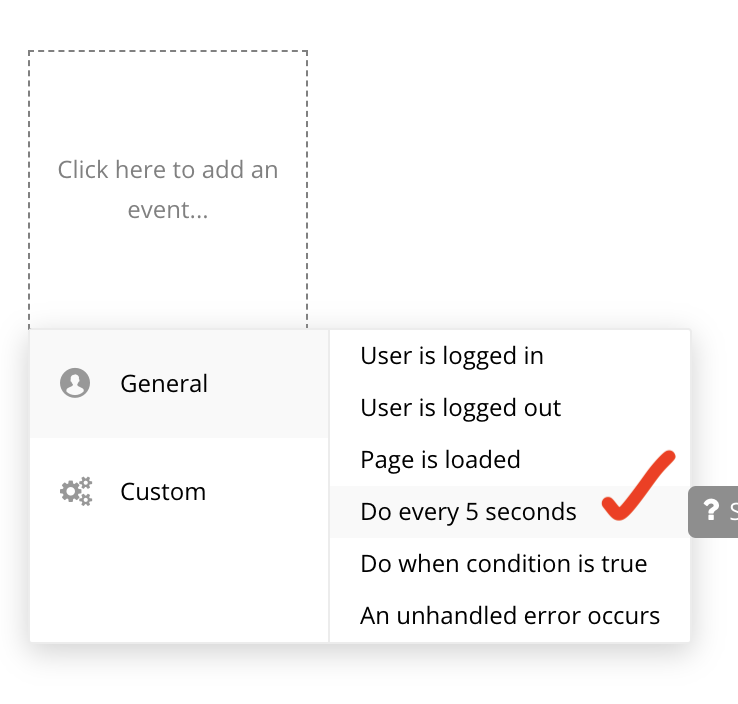

I’d use the “Do every 5 seconds”

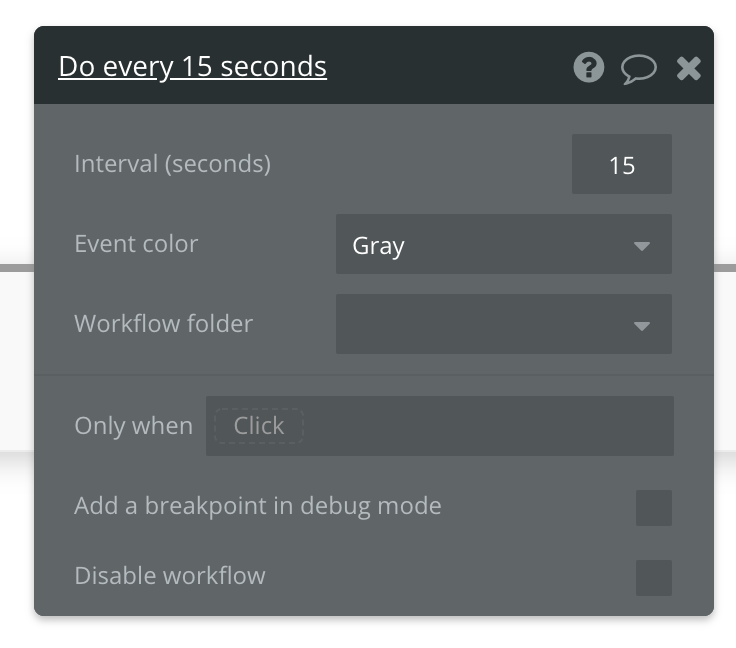

and set to every 15 seconds
and set the work flow like this.
Animate in Whatever / pause 5 seconds / Animate out Whatever / Animate in Whenever / pause 5 seconds / Animate out Whenever / Animate in Wherever / pause 5 seconds / Animate out Wherever
This flow takes about 15 seconds. Then it will restart to the beginning because you set it to do this every 15 seconds.
Hope this helps.

Actually you can use my method plus do the exact workflow when ‘the page is loaded’. This way the animation will start immediately when the page is opened and it will redo again with the ‘do every 15 seconds’ workflow.
