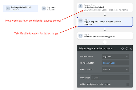

  1. Admin clicks a button to log in as another user.
  2. The workflow for that click event does two things:
    1. Tells Bubble to start watching the current user’s (admin’s) LIA Link field. (This is done via the Trigger a custom event when data changes action mentioned above.)
    2. Schedules a backend workflow which generates the login link and saves it to the admin’s LIA Link field.
  3. Bubble detects the changed field (because of step 2.1 above) and triggers our client-side custom event.
  4. The client-side custom event simply visits the link and logs the user in.
Frontend - Button Click - Step 1
Frontend - Button Click - Step 2

it looks like any user of the app can schedule this workflow and get a login link for any other account accessible in their user object.
EDIT:
it looks like adding the condition to the button workflow is enough to secure the action. I still prefer to add it directly to the api workflow but that’s just me :slight_smile:
I think adding to the action of trigger custom event when data changes a condition of current user is logged in and current user is admin will verify condition server side before setting trigger on data changes, so if user doesn’t match conditional criteria, it would not run.
Well, he’s restricted the generation using a reasonable condition (user’s roles contains admin) and would presumably have privacy rules set up so only admins can see this field, so I think that’s fine.

only the button workflow is restricted. the api workflow has no restriction so any logged in user can fiddle with dev tools and send a request to get a login link for another user (if the id is known)
my understanding here os that the privacy rule suggested is to let you see only the login links that are added to your user (admin or not)
it can be done with more strict privacy and logic but at the end of the day it’s easy to get it wrong. bubble does not expose the link client side because it’s easy to make something wrong and this is a method to go against the better judgement of the platform.
Schedule an API workflow can only be run through an action that exists inside a workflow. The action cannot be run arbitrarily outside of the context of a workflow. As long as the workflow itself has a sufficient condition (which @sudsy ‘s demo does!) it will not be possible to schedule it.
Yes, a user can inject any user into Parent group’s user, but that’s okay, because they’re an admin. It’s a non–issue here.
I see it now. To be on the safe side I always assumed you need on a condition on the api workflow itself because you could made up workflow calls on the client in the same way you can with data requests. I did try now and I see that I can bypass the restriction only for client side actions (eg toggle element) but it looks like backend actions have the workflow condition evaluated again.
that was fun to test. cheers :slight_smile:
Yeah, so for avoidance of any doubt for any future forum passerby…
  • actions can only be run within a workflow
  • element visibility is not part of the Bubble security model (hiding a button or reusable element doesn’t protect it or the elements within it)
  • a correctly configured server side expression (like @sudsy ‘s example checking Current User’s Role) can be used to secure any workflow
  • an API workflow can only be scheduled through an action, unless it is public
  • any client side actions or entirely client-side workflows can always be manipulated (by definition)
  • the concept of a ‘front-end workflow’ is inherently misleading because any workflow that has at least one server-side action (e.g updating a thing) will always hit the server and workflow conditions verified on server. Therefore, front-end workflows can be secure (though often aren’t due to user error)
