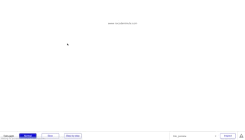

  2. I just set up an example of a Link Preview on my end and it’s lightning fast. Check out how I have it set up. The parent group has the Get Preview’s data once and then the elements inside the group just reference the parent groups Get Preview’s (Link Preview) information. This way it doesn’t try to run the API multiple times, it just does it once. Very quick. See GIF:
