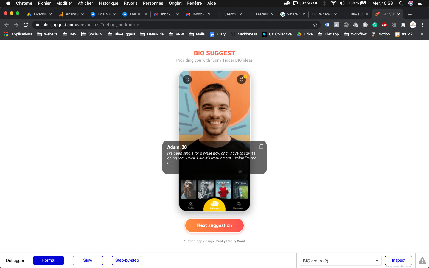

I’ve created this web app : https://bio-suggest.com/
It’s a simple Tinder bio generator with BIOs I’ve written in my database.
I’ve been struggling with the loading time Bubble takes to “Display data” in the “BIO cell” when we click on the button “Next suggestion”.
Here’s the design:
And here’s the workflow when the button “Next suggestion” is clicked:
I’ve duplicated this workflow (and design) so while the 1st “BIO + Profile” is displayed, the 2nd “BIO + profile” is being fetched.
PS : when the page is loaded, the first fetch (from the element itself aka in the design tab) is fast. It’s only the first “workflow fetches” that are slow. I’ve tried different workflows and designs, but maybe someone will know the best design/workflow for this.
