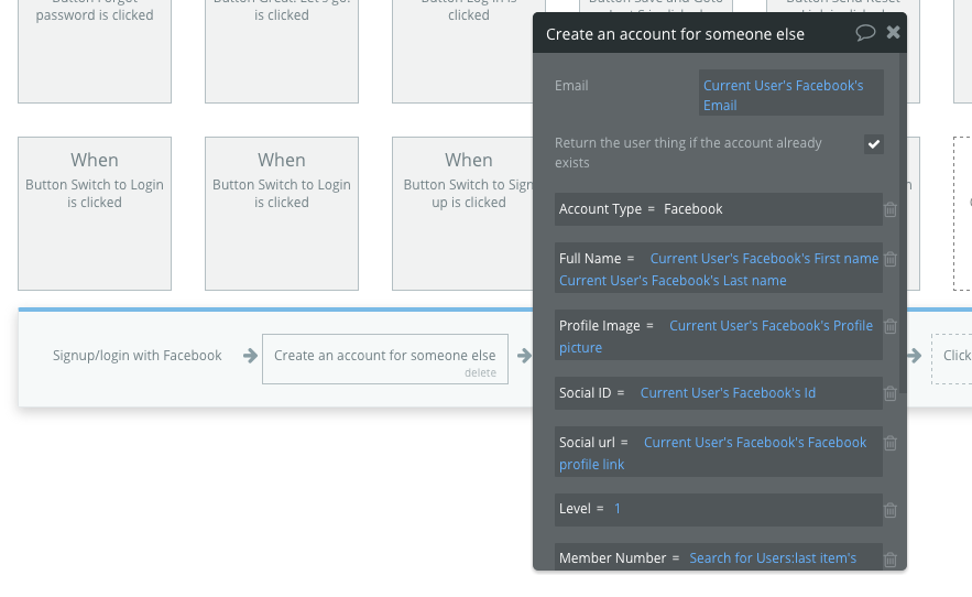

Did you try checking the box that returns the user thing if the account already exists?
That’s what I use to check if the user is already registered.
Hi @john3, thanks - I was about to say that this doesn’t apply in my case, but can you tell me more please about your workflow? In the first step of the workflow in your screenshot, you have signup/login with Facebook action - this immediately adds the Facebook user to your database, right? Then the same user is updated in the second step, even though the step says "Create an account for someone else?

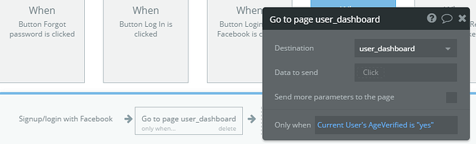

They signup/login with Facebook and you redirect them to a user area only if their age is verified.

@john3, the return user checkbox you mentioned is interesting, but I found something odd with it, or perhaps it’s just me not understanding what it is meant to do. Like the field level in your screenshot, I have a field called ‘plan’ that I set to basic for new users. If I set my workflow up like yours and I have an existing user whose plan has been upgraded to premium, when they login, the plan is being reset to basic. I thought the point of the checkbox was to spot that the user already existed and therefore not update the record but instead return the user for use in subsequent workflow steps. Do you see the same behaviour? Is my understanding wrong?
Yes I think you’re misunderstanding it - the checkbox only lets you know that the user exists - you have to do something with it. It says it returns the user thing if the account already exists. It’s prudent to assume that in bubble the workflow logic is not set unless you specify it. So you need to setup a condition to check the appropriate user thing and prevent a workflow step from running or make a different workflow step run.
So in your case you should try to use the current user’s facebook’s email and see if it already exists as your condition - if true then don’t run your setup account stuff, if false then run it. However, just be aware not all FB accounts have an email set so it might be empty. That’s why I’m storing the Social ID key from FB - you can use that to run against a new user to see if they exist already. So far I think it’s ok but you may also need to ask them for their email if that doesn’t provide enough confirmation - then run that email against your database to see if it already exists.

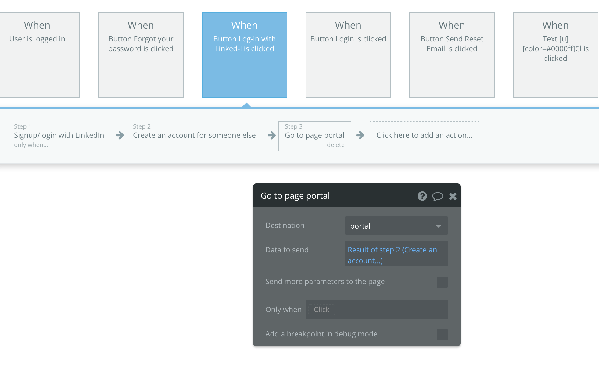

I’m also trying to implement a LinkedIn login/signup but I can’t prevent the system from trying to create a new account every time. In my mind, I think the workflow that I have tries to log the user in, if the account exists - it returns the User then I pass that to the portal page. What happens instead is that it just says the email already exists. Any help you could provide (with screen shots) would be awesome! Thanks!
-Scott
