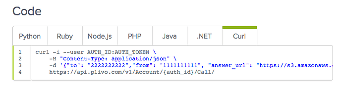

Most API seem to give many option of language to be integrated. The simple one is Curl here.
  1. What is the best (or easy one) language to implement in Bubble API Connector?
  2. CURL
  3. Node.js
  4. How to make it work with API Connector? I passed many hour just guessing…
and you probably know the error message…:
Any way to go step by step?
curl is a command line thing. Like Postman for people that do coding stuff :slight_smile:
You can’t put that into the body of the API (although Blockspring did provide a way to “curlAnything” but I could never get it to work and I ain’t paying for it now).

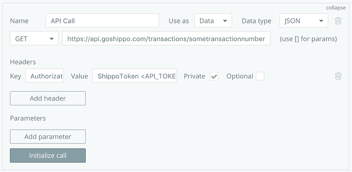

It’s a shippo API call
@SEmvp - You’re best off taking look at Curl. Shippo gives this as a transaction example:
curl https://api.goshippo.com/transactions/70ae8117ee1749e393f249d5b77c45e0 \
    -H "Authorization: ShippoToken <API_TOKEN>"
In Bubble it would look like this:
Just replace “somerandomtransaction” with your desired transaction number (or enter dynamically in a a workflow), and <API_TOKEN> with the API token that shippo provides.
In general, it’s a good rule of thumb to try the call out with Postman first, and then copy/paste into the API Connector when it works correctly.

Would it not be a second header value in the bubble api connector? You’ll have one for the Authorization, and another for key SHIPPO-API-VERSION with value 1.0.
