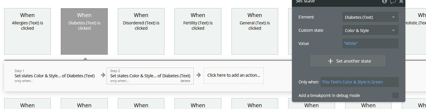

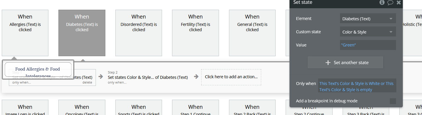

I’m using custom states to change the background color when specific text is clicked. I was able to do that successfully, so now when a user clicks the text, the background color changes to green. The problem I’m having is that I would like the text background to change back to white if the user clicks the text again, and then back to green if it’s clicked a third time. I haven’t figured out how to do this.

You would need to have 2 workflows for this one.
One for when text is clicked and text’s state is yes and one for when text is clicked and text’s state is no
For the former, simply have an action to set state of the text to no. And do the same for the latter workflow but set its state to yes

worflow for clicking text is 2 workflows
when “change color?” is no, set state to “change color?” yes
when “change color?” is yes, set state to “change color?” no

Thanks very much! This worked. I realized you had to create two separate workflows.
