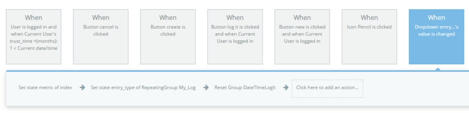

  • make a workflow with at least two actions; the first action will set the custom state curr_date_time to the “current date/time” and the SECOND action will reset the DateInput
So it’s like the dropdown changing updates the date/time in the custom state, then the condition updates the initial content to reflect the custom state, then the reset changes the DateInput’s value “back” to its initial condition.
It’s a silly work around, but the emphasis is on “works”.

So you got the DateInput to change it’s value just by setting its initial content to its custom state and then changing the value of the custom state itself? I could have sworn that changing the custom state wasn’t working for me. Maybe I didn’t try it in that exact combination. The custom state’s value would change, but the value displayed in the DateInput wouldn’t change.
That’s right, if you open my live demo page, you can see it updating with each minute. (you did change the default interval from 30 to 1, didn’t you…)
