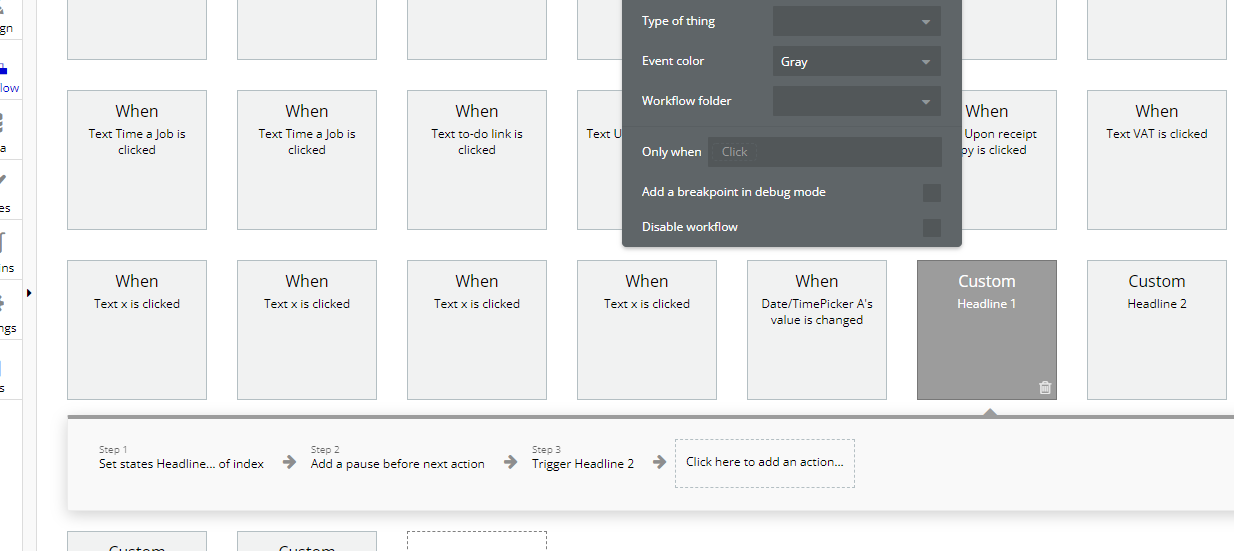

Create two CUSTOM EVENTs as showned below.
One called “Headline 1” and the other “Headline 2
Event “Headline 1”:
  • In your first step you will change the value of your index’s Headline to “Hello, welcome to my site”.
  • In the second step, you will create a pause of 3 seconds.
  • In the third step you will trigger a custom event → Choose “Headline 2
Event “Headline 2”:
  • In your first step you will change the value of your index’s Headline to “We hope you are happy”.
  • In the third step you will trigger a custom event → Choose “Headline 1
In your event “On Page Loads” you will only need one step:
  • In the first step you will trigger a custom event → Choose “Headline 1
Make sense?! :+1:
Yes, this is a very nice and simple solution … but oddly it stops repeating after it’s shown Event 1 twice, like this;
Headline 1
Headline 2
Headline 1
… then it stops?
I have no idea why (or how) it can stop because Headline 1 should progress to Trigger Headline 2.

Hummm, you are right… Circular reference… Bubble will not allow it…
So, there is another easy way…
  • In your third step you will change the value of your index’s Headline to “We hope you are happy”.
Every 6 seconds, Bubble will cal this workflow.
So every text will be displayed for 3 seconds.
Tested here. Worked fine.
