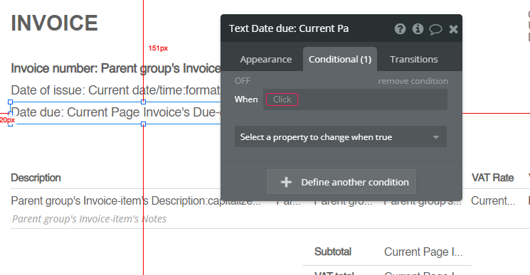

I can’t figure out why this conditional is red text.
The default for this text shows the invoice’s Due-date, and the conditional should show the words ‘Upon Receipt’ When the Due-date is today’s date.
The invoice is created inside a group on the index page (single page app) and the User selects date choices from a popup. Then, the save button sends the popup data to the DB (see below) before navigating to a new page “preview-html” to preview the invoice.
Your conditional needs to say when something is true. All you’re saying here is to take the due date and add 0 days to it. There is nothing to prove as true or false.
Try saying when Current Page Invoice’s Due-date is Current Time/Date
It’s red because it’s not complete (it doesn’t make sense as it is)…
A conditional has to evaluate to either yes or no. Currently your conditional evaluates to a date/time (although even that doesn’t make sense - you’ve got a date plus zero days, which is the same as just the date on it’s own).
In any case, you need to finish the expression so that the output is a yes/no (true or false).
You should change the 0 with the number of max days to pay the invoice, let’s say 14 and then continue the expression by comparing it to the current date.
Thanks, I have tried everything I can think of but I always see red error text. What I want to say is When Current page's Invoice's Due-date is Current date/time then show ‘Upon Receipt’ .

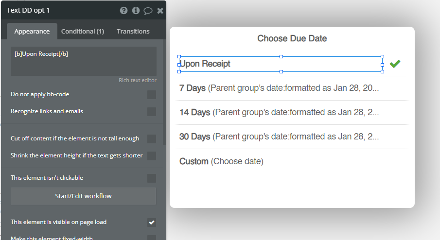

For more context, here is the popup Data source for Current date/time. If a user choses this date, then the Current date/time shows, which is fine, but it looks better on the invoice to simply say 'Upon Receipt’.
And for added context, here is what the Data source shows if a user selects payment due 7 days from Current date/time.
The max days has to be 0 because what I want to say is When Current page's Invoice's Due-date is Current date/time then show the text ‘Upon Receipt’ . Since the option to refer to Current date/time is not available, I am trying to refer to Day +0 (ie. today).
I just want an option for the user to choose ‘Upon receipt’ which doesn’t need to be a date/time at all, it could be text. But, I can’t even do that!
If that’s what you want to say, then say it - that’s a perfectly valid expression for a conditional (it’s either true or it’s false).
But I doubt that really is what you want to say, as that will only be true for a single millisecond…
I’d guess that what you’re really trying to do is show the alternative text if the due date falls on today (or presumably any date prior to today as well). In which case you can simply use when due date < current date time: +(days) 1: rounded to Day
I can’t complete this expression as I am being asked to format it as text or number, both end up with red text.
I can’t, there is simply no option to select ‘Current date/time’. So, I am doing something very wrong.
I’ve even tried just having text, so the user can literally just choose a text input. But when I head over to the html-invoice page and try and show this result as a conditional I am unable to refer to the text input.
Try it the other way around (Bubble has some strange limitations with the way you can write conditionals and expand on certain expressions).
But do it backwards and it should work just fine.
i.e. current date/time +(days) 1: rounded down to Day > parent group's Invoice's Due Date
It works fine for me.
That worked! I was really impressed with this part > parent group's Invoice's Due Date - I would never has thought of that solution. Thanks very much, I tried for best part of 2 days on this crazy little problem!
