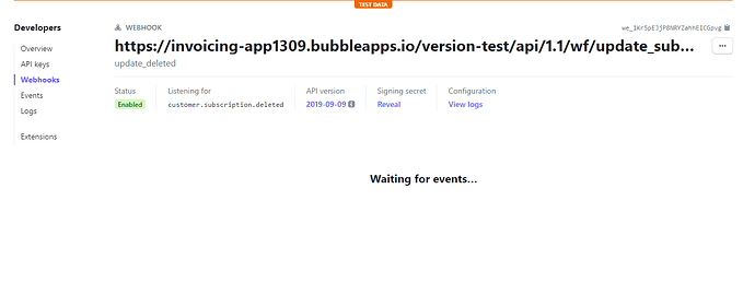

Still, the issue remains that I cannot set up new webhooks, here are the steps I take;
- Create API workflow in Bubble’s backend
- Click ‘Detect data’ on the API workflow
- Go to Stripe and ‘Add endpoint’
- Endpoint page gets stuck ‘Waiting for events…’ and Bubble doesn’t recieve any webhook data
The odd thing is that I did create a webhook several months ago which still works. If I click ‘Detect data’ on the API workflow and resend the data from
Stripe it works fine. For some reason, new webhooks are not working.

How are you triggering the event?..
Stripe recently removed the ability to send test events from the Dashboard, so to initialize the call you’ll need to actually trigger the event somehow from your app…
Alternatively, you can use the Stripe CLI to send a test event.
I haven’t personally used it (as most of my Stripe webhooks were set up before they took away the ‘send test event’ function, and for more recent ones I just send an actual event from my app), so can’t say too much about it, but having had a quick look at the docs it seems straight forward enough to use…
When you create a new webhook in Stipe, the final save button ‘Add endpoint’ automatically directs to a new page which (used to) automatically send data to the Endpoint URL address specified during the webhook creation.
This would explain why my older webhooks work, shame Stripe’s support failed to mention that! Regards to the link you kindly recommended, the first step to Install the Stripe CLI (on Windows) is to download stripe-cli from github, but githib pages don’t provide a download button!?

No it doesn’t (I’m not sure where you’ve got that idea from?..)
Once you add an endpoint in your Stripe dashboard it just says ‘Waiting For Events’ (as you’ve already shown in your screenshot) until the first event is triggered.
You need to trigger it somehow (or use the CLI - but the easiest way it just to trigger it yourself)
