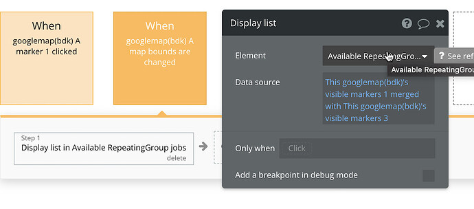

Hey it’s been awhile since I worked on this, but I ended up doing a temporary solution in which the Repeating Group list updates to only show the map markers that are visible on the map. So when the user zooms in/out, the list updates accordingly. I figured this would be a short term solution while I continue to build the rest of the site functionality.
(I plan on revisiting the suggestion from NoCodeVenture on displaying the marker id inside state to reference that particular cell/pin, but haven’t had time to do that yet.)
My current process is as follows:
(Using Google Maps BDK plugin)
Create Workflow > When ‘Element’ ‘google map bdk map bounds are changed’ > Display List Element = [select your repeating group] and Data Source = This ‘googlemap bdk’s markers’ VISIBLE MARKERS
This will update your repeating group to show only the visible markers on the map.

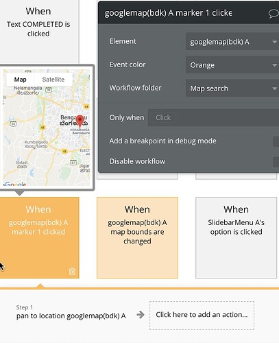

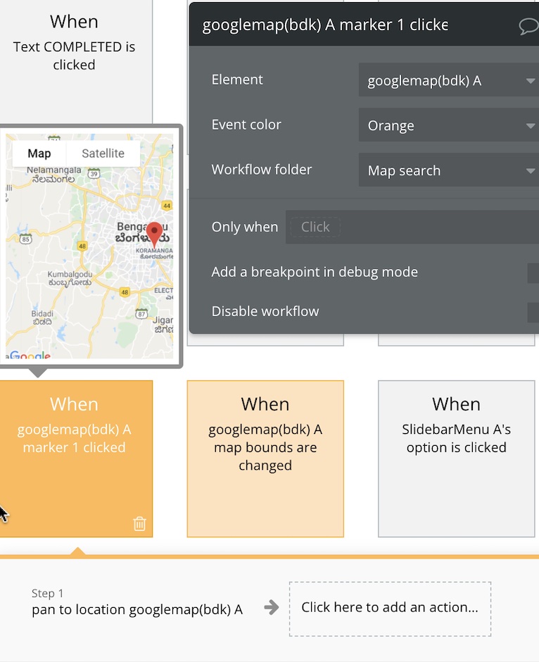

Just as fyi, I also have a separate workflow to ‘pan to the location’ of the map marker when it’s clicked.
