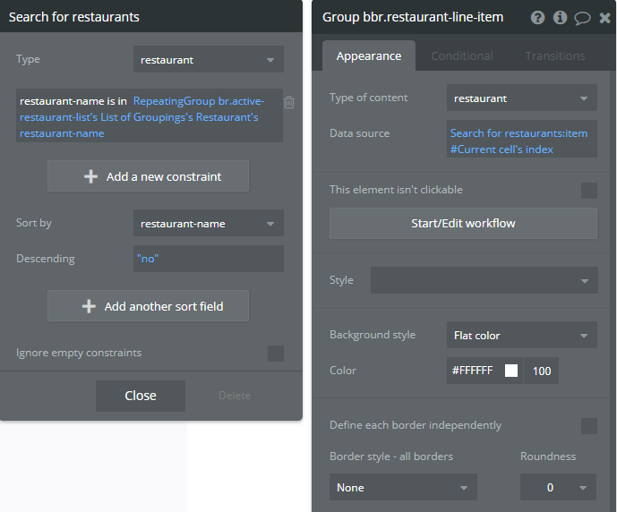

What you have to do essentially is create your repeating group normally like you have been, and use the :grouped by like normal. However, in each cell of your repeating group, you need to add another group. You can then set this group to be the elements you need by using the repeating group as a list of data, and matching it against search results, using the cell index to create the new list.
Since this is very confusing, here’s a screenshot of how I set up that group that’s in each repeating group cell (group on the right, search being run on the left):
I can now sort by any field for my data types! Hope this helps :slight_smile:

So, the problem with using :grouped by is that you are only able to sort the “groups” by Bubble’s default sorting. I looked around a lot, and didn’t see any easy way to fix this, so a work around had to be created.
In general, what I can sort in Bubble is data returned from a search. The other comment mentioned that this isn’t efficient since it’s being ran on every cell (unfortunately), but it works, and will only do a search through the data that’s in your repeating group, since you’re selecting that as the source. Searching is also much faster than filtering.
The search we perform in the new group we created (which is in each repeating group cell) is just there to return the same data as the repeating group, so that we can manipulate it the way we want. From there, we do the type of sorting we want. In my case, I wanted to sort by a restaurant name.
Now each cell will return that same sorted data. To access the data you need, you select the one that is at the current cell’s index!
Confusing as hell, I know - it took me forever to get to that point. Hopefully that helps clear things up a bit.

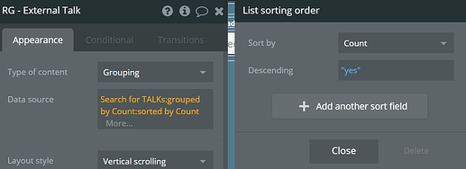

You can sort a groupedby repeating group by date if you group by a field that counts the things in the Type as they are created, with the most recent ones always having a higher count than earlier things and in date-order.
I used the following repeating group within a repeating group approach that focuses on sorting by date.

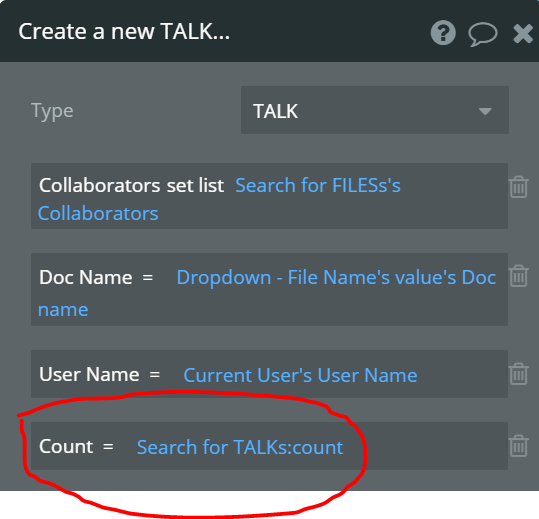

  1. groupby a field that counts the number things using a Search for[Type]:count expression. This field is created when a button is clicked or other workflow is initiated to create a thing.
  2. sort by that field in the repeating group’s Data source expression
  3. Set that sort be descending or ascending as you want.

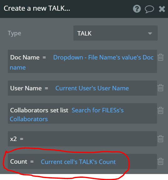

  4. Set new things created in the internal repeating group to be the count of the external group’s cell.

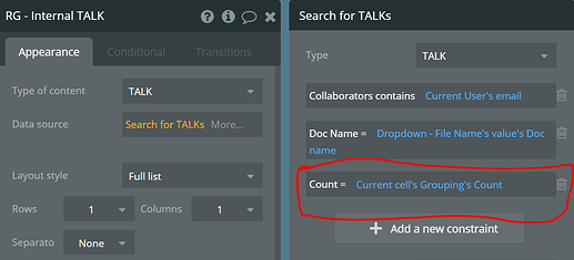

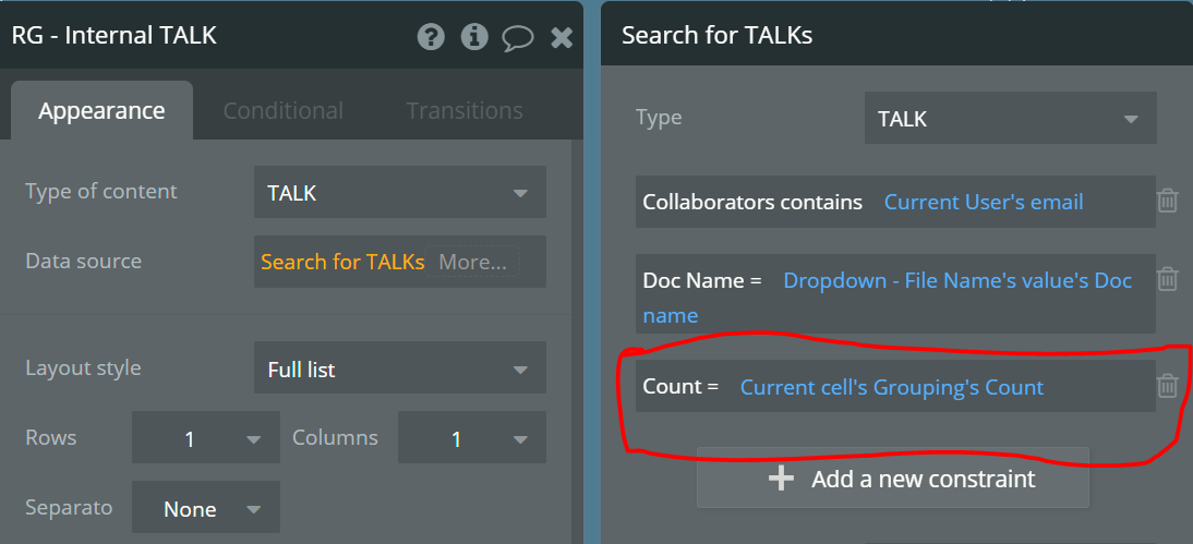

  5. Filter the things in the internal group by the external group’s groupedby field (the “Grouping”).

For my app: I have a data type called TALKs. When you click Add Comment to add a thing to the external RG (a comment), it adds a field I called Count that counts the number of rows/things. I groupby that field because it will always be adding to the number of comments that I want to groupby.
Below you can see what I’m referring to.
  1. When the Add Comment Button is clicked
2. and 3
4.
(this is what happens when the reply button from the internal repeating group is click to create a new thing)
5.
