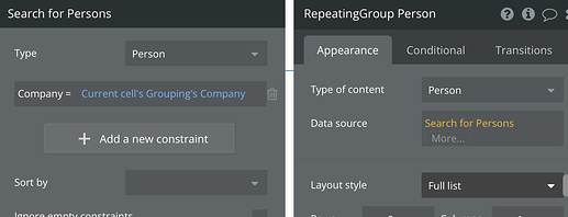

One way to achieve this result is to use two repeating groups. This can be inefficient with large datasets, but if I understand your question properly, it will provide a solution.
The first repeating group is used as the outer grouping, the inner repeating group is used to display the data. In the first repeating group, you will want to use a group by on your data source and then sort by the column you are wishing to have your list sorted by (i.e. Brand if you are trying to achieve Brand → Product). The second (inner) repeating group needs to have a constraint that restricts it to only the values that match the first repeating group. After that you can sort by Product (or any other column you choose. See below:
Screenshot 2022-05-17 at 4.00.44 PM
You can review the implementation here: Double-trouble-bubble | Bubble Editor
Thanks a lot for you’re answer. It worked like a charm.
Took me some time but i figured it out with you’re example and explanation.
A lot of records need to be loaded but with ext. vertical scrolling it seems not to be that inefficient .
