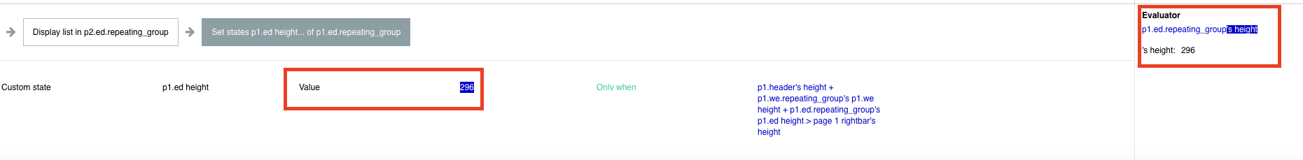

now the problem is that the custom state does not set the height of education correctly after you have limited the number of items of education
The height of the first set custom state of education is 296:
I display the items from education until 1:
after I set the custom state again, but the value is 296. the value should be 148:
I have already added a pause but it has not solved the problem.
do you know how i can fix the problem?
