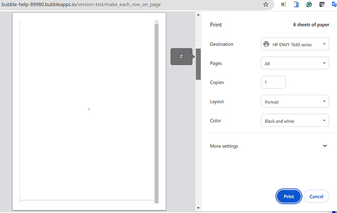

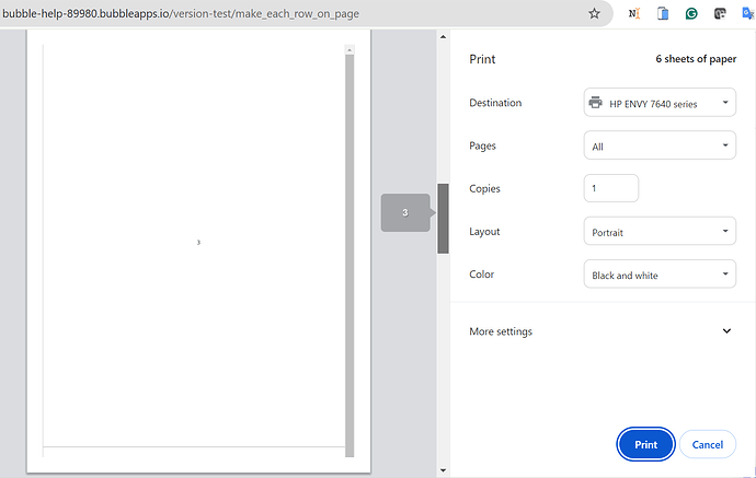

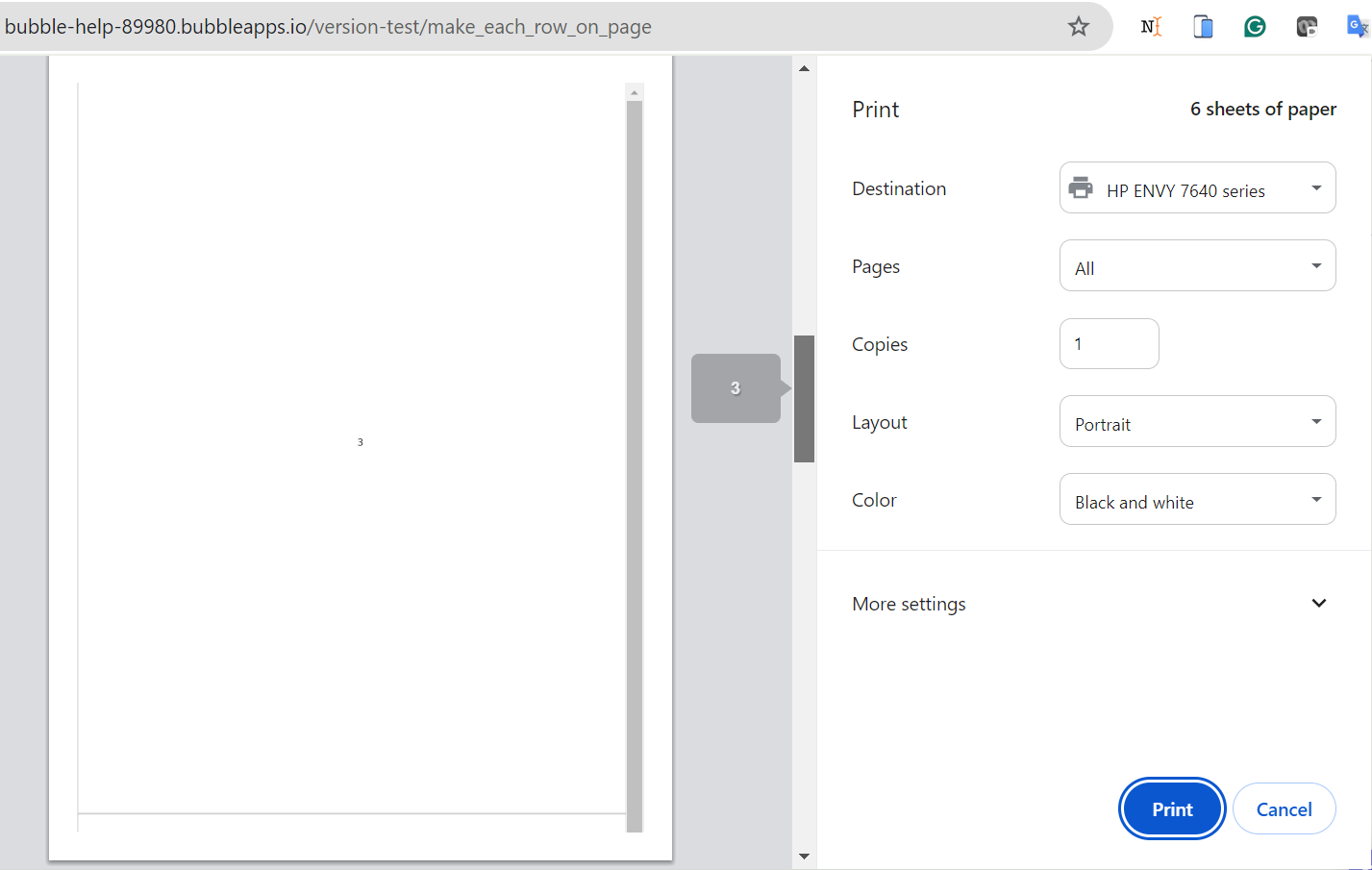

I tested your sample and it does not working, please see screen shots below, look at the bottom line, it is getting higher and higher on each page…
