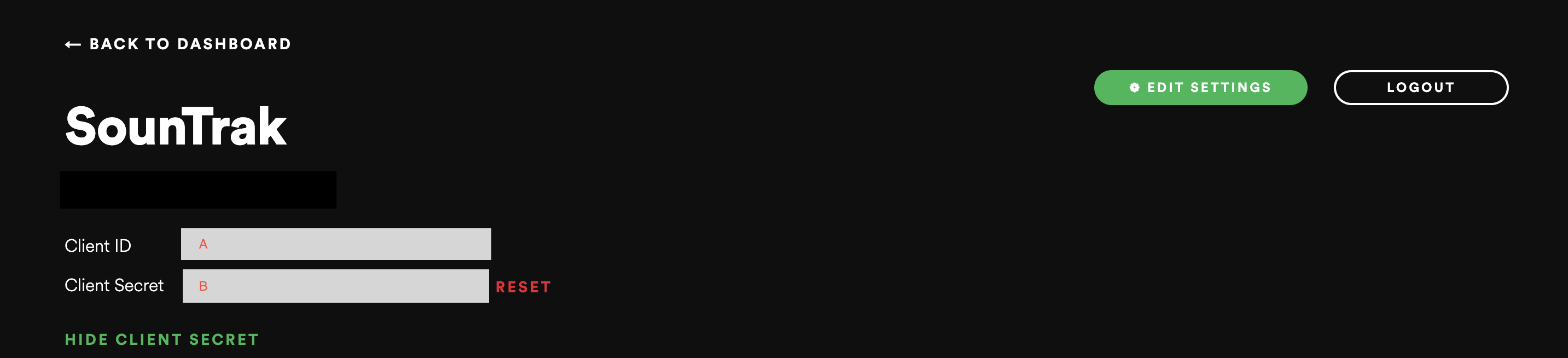

Hey! I was wondering is anyone familiar with the Spotify connect app. I can’t seem to get pass the setting up search part I created a Spotify developers page to get my authentic keys but it’s didn’t say authentic keys it said client id client secret so I’m not sure if that’s right
But if you could give me a few pointer that would be great ! Thank u

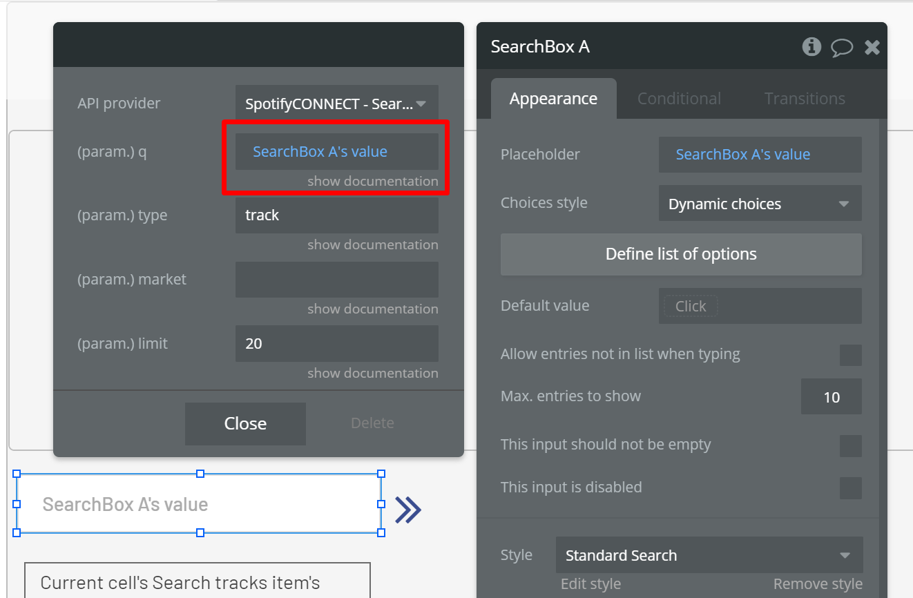

So this is your current configuration :
The searchbox work this way : it search for elements in a list and allow you to select an element. When selected, this element will be the searchbox’value.
If we translate your current configuration, we have this:
- Searchbox’value list of options (values to select) is searchbox’value (so it’s empty because any option is selected)
So you may use an input field instead of the searchbox, and then set the repeating group API source parameter Q as this field value, which is a text value and not an element value
Hope my English explanations are clear
Let me know
