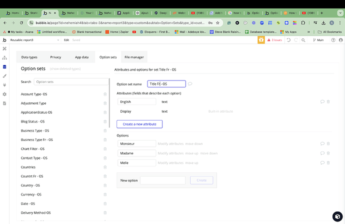

In your setup, if you really want “Monsieur” (I am French, that the right name by the way) to be stored in database. You option set should look like this:
Attributes: display, language
Options:
  • Mr, EN
  • Mrs, EN
  • Monsieur, FR
  • Madame, FR

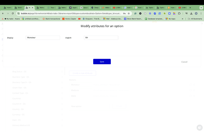

Thats my DB setup above for the Option sets
for switching between the option set and its attribute I use the following conditional
I have an option set that sets the language which I also use and attribute on the Option set e.g English is 1 and French is 2. so based on the language number for each user display either the option set or the option set attributes.
