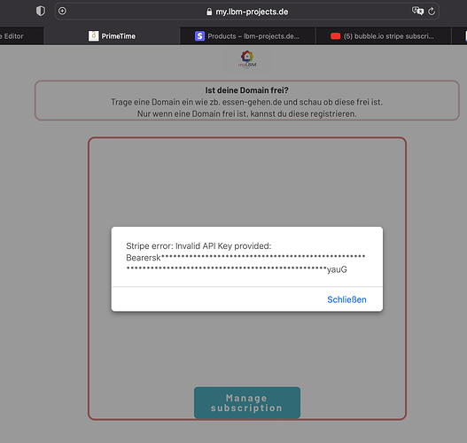

Now I get this error
Invalid APi Key but I just copied and pasted it, I check also few times, its same API public and secret I added.
take out Bearer and republish
