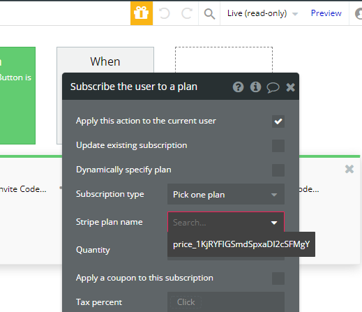

I’m testing out the live version of my app using Bubble’s Stripe Plugin. I was able to test and confirm the TEST/DEV keys and subscription flows all work, but when I place my LIVE API keys and remove the developer keys from the Plugin, I’m no longer seeing any products. I created a product on the Stripe side on LIVE, so it should be pulling in 1 plan.
Maybe I am missing a step?
EDIT
When I switch to LIVE mode, I can actually see the LIVE Stripe Plan this workflow should be using, but I can’t make any edits/save in “live” mode?

For those wondering, here’s how I got this working:
When the user clicks subscribe to plan, check “dynamic” and then paste the ID of the LIVE plan from Stripe. You’ll still need to keep your dev key and secret otherwise you won’t be able to publish to live.

Hey @trvshowell- just to recap, you were seeing your test products in the dropdown but NOT your live products, correct? As a result, you had to check off dynamically specify plan and add them manually. Same thing has been happening to me for months which makes testing a real pain. I still wonder if this is a bug on Bubble’s end and I think I’ll file a report to find out.

Hey! Think I just figured this out. What you have to do is add “Isn’t live version” = “Yes” at the bottom “Only if” area for the Dev/Test Product ID. Then duplicate that Workflow, replace the Test Product ID with the Live Product ID (by checking the “Dynamically specify plan” checkbox and then manually entering), and change to “Isn’t live version” = “No”. Doing this will allow you to dynamically swap Product ID depending on whether you’re in Dev or Live mode.
