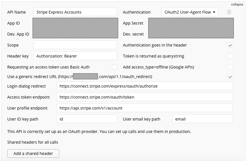

I was able to get the API properly set up as an OAuth provider using the following API connector. The seller registration works and re-directs back to my website. However I realized that I was going to need an extra step because transferring a payment to this seller did not work (error: payee was not found). I believe this missing step is Step 4 of the Stripe docs referenced above.

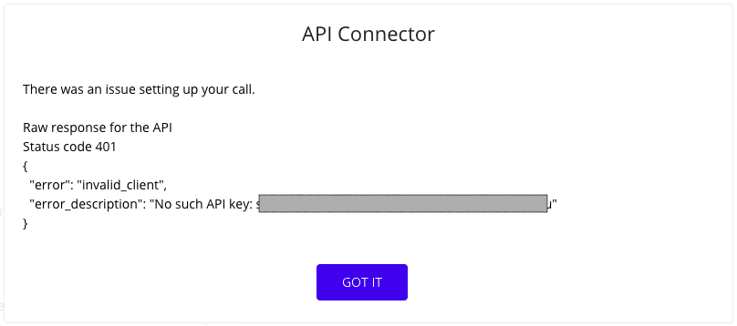

However when I initialize the call, it prompts me with an error message that the API key does not exist. The API key listed does not match any of my Stripe API keys so I’m not sure where it’s pulling this from.

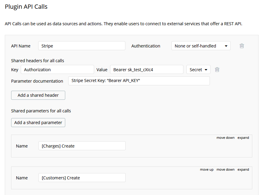

Did you put Bearer in there, might help. Here’s how I set up my Stripe API calls.

I’ve updated my API to use the same authentication method you used. I also created an API call to GET the authorization code as shown below.

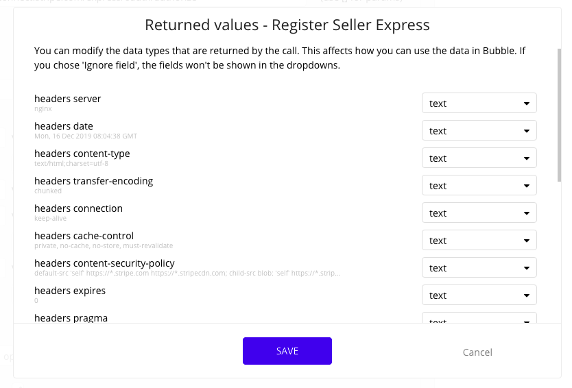

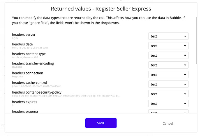

But when I initialize call, I’m not seeing the authorization code in the response.
And when I run my app with this action in the workflow, I get the following error message.
Error Message
How do I obtain the authorization code so that I can use it in my POST API Call and complete the express account connection?
Is that user profile endpoint correct? I’m trying to set this up myself and the custom account curl is curl https://api.stripe.com/v1/accounts (not account)
Hi Matt,
Thanks for the reply. I think you’re right based on the docs here: Retrieve account | Stripe API Reference
Just having ā€œaccountā€ retrieves my account info.
However, when I changed the endpoint to https://api.stripe.com/v1/accounts, I get the following error after attempting to register a new seller.
Screen Shot 2019-12-19 at 2.22.18 PM
Have you reached this error?
